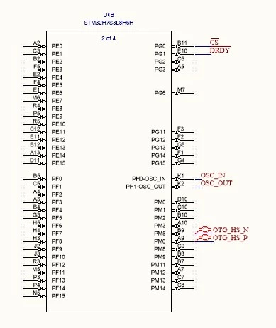

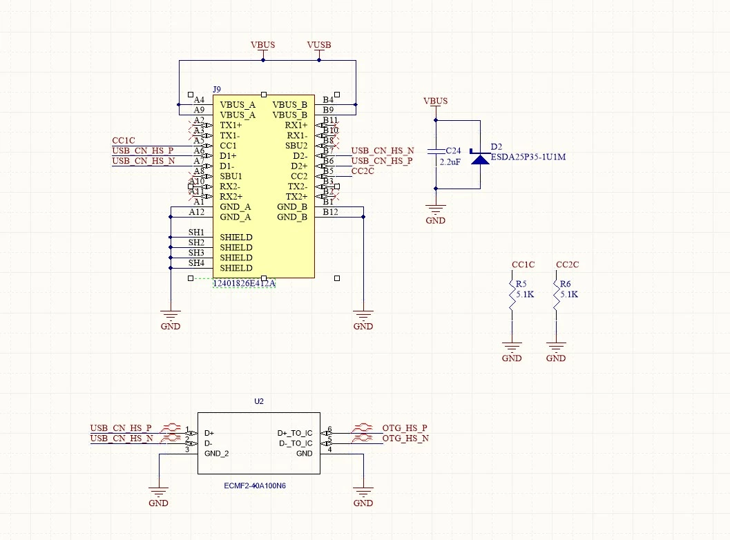

I am designing a system to interface an ADC via SPI and send data through the USB (VCP) to a PC.
I tested the flow using NUCLEO-H7S3L8, and everything was working fine so i moved to the design of a PCB.
When uploading the same code i used on the dev board the USB never shows up on windows device manager. I am able to debug the code using STlink and no error is thrown.
My hardware does not include the TCPP03-M20 chip because i am not planning to use Power delivery functions, thus i am connecting CC1 and CC2 with 5.1Kohm resistors to GND.
My device is USB powered so i am not sensing the VBUS.
Attached i have some prints of the schematic.
Another difference is the HSE crystal, the one on the Devkit is NX2016SA-24MHZ-EXS00A-CS10820 and i am using NX2016SA-24M-EXS00A-CS08891.
Thank you all in advance!

USB Device mode is forced in the software (since VBUS sensing is disabled). In usbd_conf.c, set:
#define PCD_VBUS_SENSING_DISABLED
Also, check if the USB power supply is stable. For more info about making your own STM32 MCU board, you can see here:
https://www.pcbway.com/blog/25/Tutorial__How_to_Design_Your_Own_Custom_STM32_Microcontroller_Board.html
andr3Author
February 25, 2025
I added the define and the output is the same. But it might have something to do with that because on the Devkit, the power comes from the STlink connector.
I will investigate the USB power supply.
