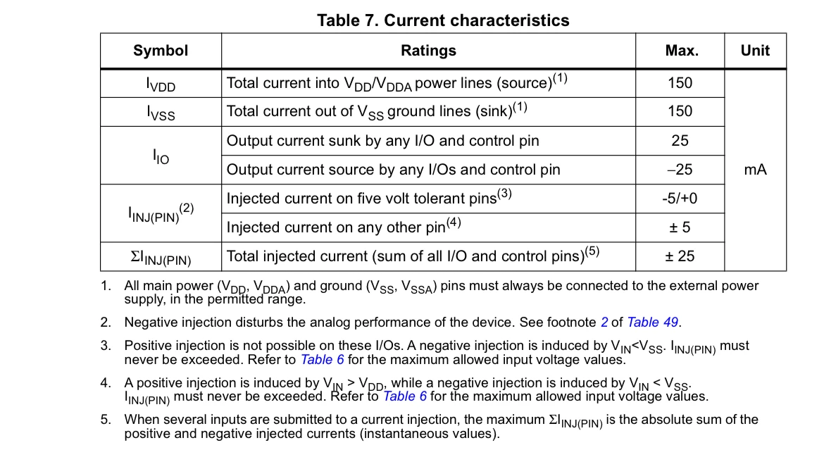

What will be the total output current sunk by sum of all I/Os and control pins and Total output current sourced by sum of all I/Os supplied by VDDIO2 of STM32F103RBT6?

Dear @stu1 ,
We have no VDDIO2 internal Rail in the STM32F1 series , all VDDx should be connected to the same board Rail . Here is the datasheet for more details
https://www.st.com/resource/en/datasheet/stm32f103rb.pdf
Hope it helps you .

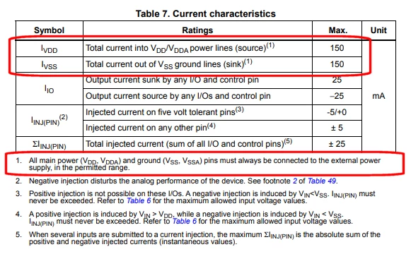

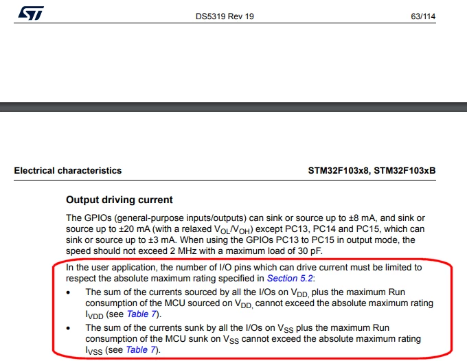

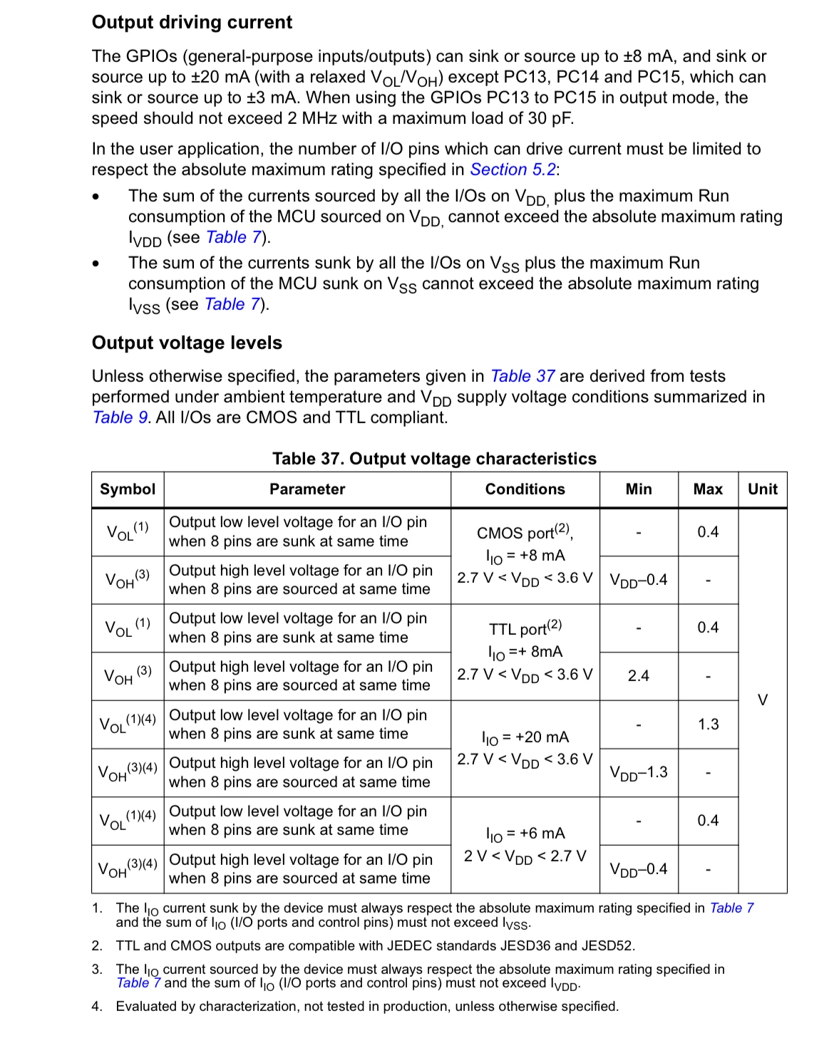

stu1Author
July 1, 2024
Correct. So, I required how many LEDs I can connect to this controller for single unit of time. How much amount of current all the GPIOs can handle at a time?
Andrew Neil
July 1, 2024
That was answered in the images posted by @STOne-32
