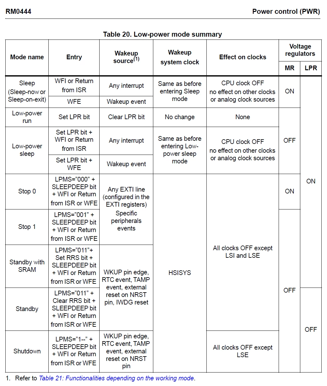

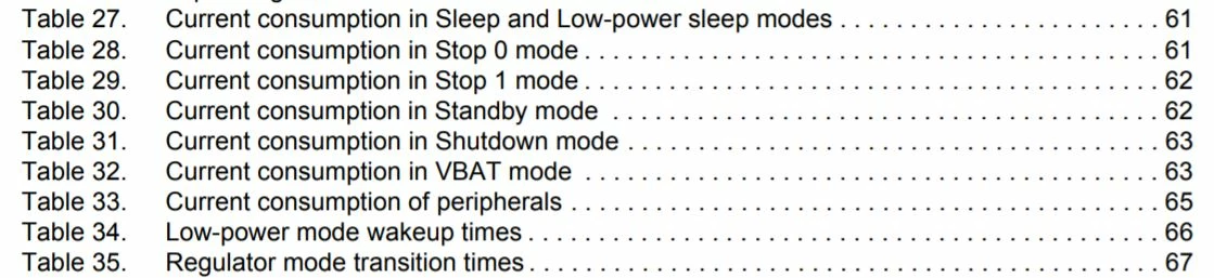

Current Consumption of STM32G071GB in deep sleep mode?
What is the current consumption of STM32g071GB in deep sleep mode?
I found the tables of current consumption in the datasheet, but I am not certain which is the deep sleep current among the list. I have seen the following:
