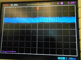

I measured the current consumption of STM32F3 discovery board from its Idd pin and I always see the current consumption decreasing with time over a period of 50-60 seconds and then shoots up to the initial value. I used a standard example from ST STM32F3-Discovery_FW_V1.1.0\Project\Peripheral_Examples\ADC_Example and tried putting a while(1); loop as the first line of main().
I have found the same effect on STM32f373 MCUs as well.
Can someone tell me the reason for that and how to rid of this saw tooth behaviour?
Please find attached the screenshot of the behaviour from the oscilloscope.

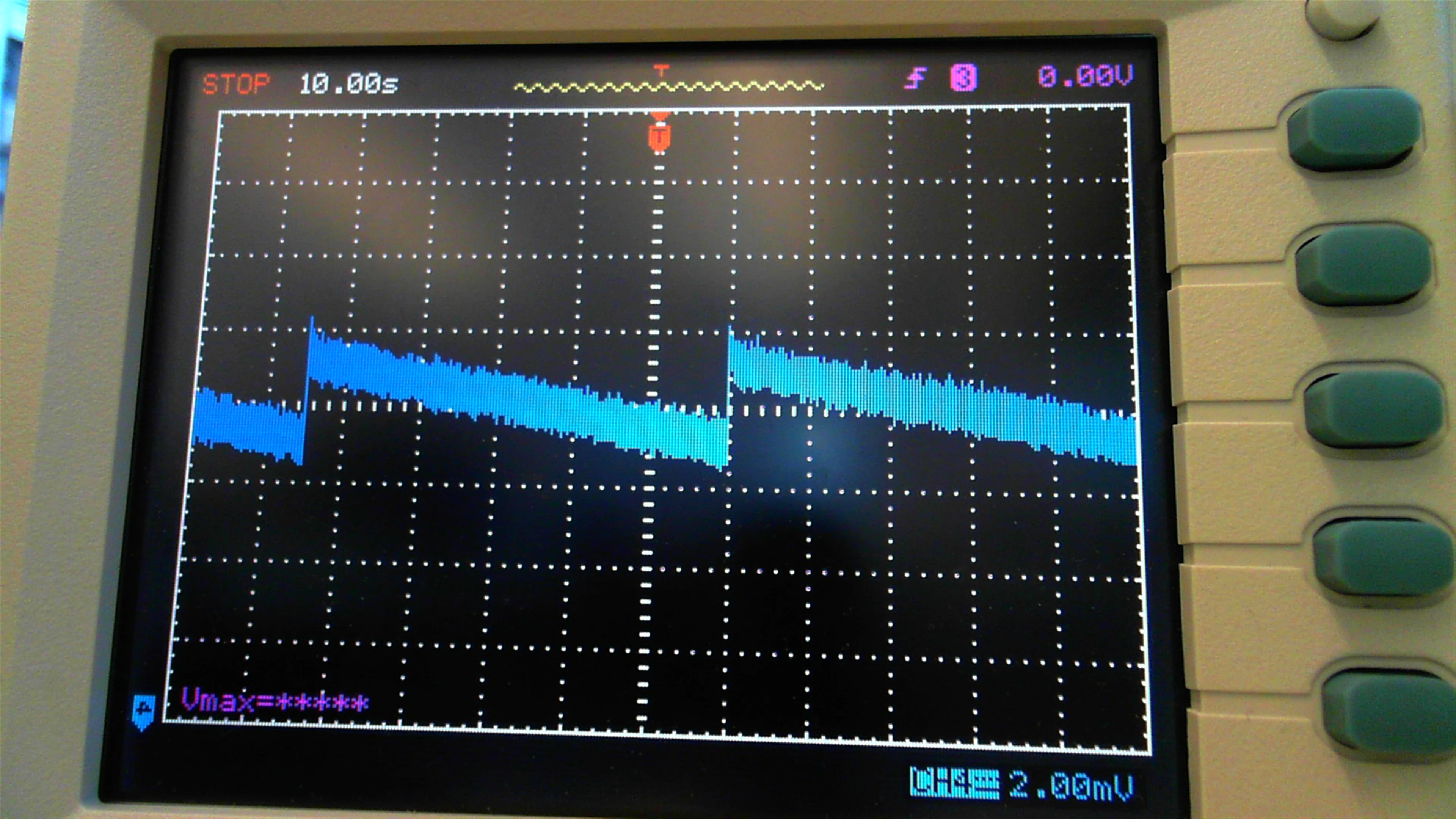

The absolute value of current varies depending on what peripherals I enable. Currently, when no pheripherals are enabled, the current consumed is roughly 3.15mA with amplitude of 72µA for the saw-tooth. On the scope (Rigol DS1204B) the blue signal is a measurement with a current probe (Agilent 2005, PowerSupply N2775A)
, the factor is 40 and the result is in mA.
Yes, the period is 55 seconds.
The ADC is not even initialized! It is like:
int main(void)
while(1);  ...
Only the startup_stm32f30x.s code should run.
I just took a sample project from the ST example as I have seen the same effect in my code which is an entirely different project.
I've also made the measurement without ST-LINK (please see the picture attached).
