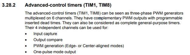

I have read RM0433 and DS12110 . TIM1/8 has 4 Channel. But in CubeMX v4.26 I can see 6 Channel in CubeH7 v1.2.0.
Is this a bug?

Hello
Belter.Chris
The STM32H7 reference manual and datasheet mentioned that there is 6 channels for TIM1 and TIM8.
For example for TIM1, they have these channels:
TIM1_CH1,
TIM1_CH2,
TIM1_CH3 with
three complementary channels:
TIM1_CH1N,
TIM1_CH2N,
TIM1_CH3N.
With Regards,
Imen.
