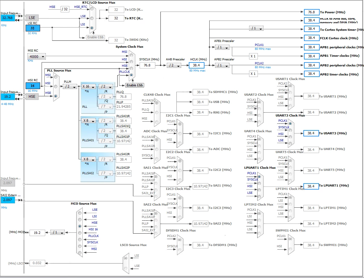

Hi guys,
I am running into some timing issue using CubeMX, probably after upgrading to the latest version. A couple of weeks ago I noticed my SysTick running roughly twice as fast as expected (half of 1ms) so I changed my 1ms systick to Timer2 which worked fine. Today I turned on my USART3 for the first time at 9600 BAUD and could not get the HyperTerm to receive correctly (all garbage). Then I took a closer look at the signal through the scope and noticed the BAUD was actually at about 23KBAUD, which was weird because I set it in the code as:
huart3.Init.BaudRate = 9600;
After mucking around I got the HyperTerm to work normally by changing the BAUD setting to:
huart3.Init.BaudRate = 4000; // This is actually 9600 BAUD (verified with scope)
I have a hunch the BAUD rate issue is related to the SysTick issue.Anyone has this issue or is familiar with CubeMX to give me a clue here?
Thanks,
ED

    Let's start at the start, are you really running a 19.5MHz external crystal?
    Andrei
    e d
    e dAuthor
    Jun 7, 2017 9:54 PM UTC
    Posted on June 07, 2017 at 21:54
    19.2MHz to be exact. As I stated, I programmed the timer2 to run at 1ms interval with no problem so the timing for APB1 at 38.4MHz based on the 19.2MHz external crystal should be correct.
    htim2.Instance = TIM2;
    htim2.Init.Prescaler = 383;
    htim2.Init.CounterMode = TIM_COUNTERMODE_UP;
    htim2.Init.Period = 99;
    Besides, SysTick should run at 1ms no matter what, am I right?

    I can confirm that generating the SPI2 code using HAL instead of LL fixes the issue of SysTick timing and UART BAUD rate anomalies. This is quite disturbing as a programmer so can anyone let me know if this is an intended behavior?!?

    I think I found why this would happen.....
    using HAL library, here my Crystal is 9.8304MHz
    in file stm32l4xx_hal_conf.h , you can find this macro
    #if !defined (HSE_VALUE)
    #define HSE_VALUE ((uint32_t)
    9830400U
    ) /*!< Value of the External oscillator in Hz */
    #endif /* HSE_VALUE */
    Once you choose LL drivers, the project includesstm32l4xx_ll_rcc.h
    Unfortunately, the macros in stm32l4xx_ll_rcc.his still as followed:
    #define HSE_VALUE 8000000U /*!< Value of the HSE oscillator in Hz */
    If you manually modify this value to your crystal's frequency,
    If you define the HSE_VALUE in the project setting (thanks
    meyer.frank
    ‌ for reminding this!)
    for example, in keil,
    Everything would work as you expected!
    Guess we need ST guys to fixed up the library.

    I would not bet on that - this issue was already present in the 'old' Standard Peripheral Libs.
    Instead of throwing an error (' ♯ error 'define a HSE_VALUE !'), these guys presumed to define a default.
    This threw many users off the track initially ...
    The best place to define HSE_VALUE would be your project settings (or a make file).
    Editing the header file is not a good option.
