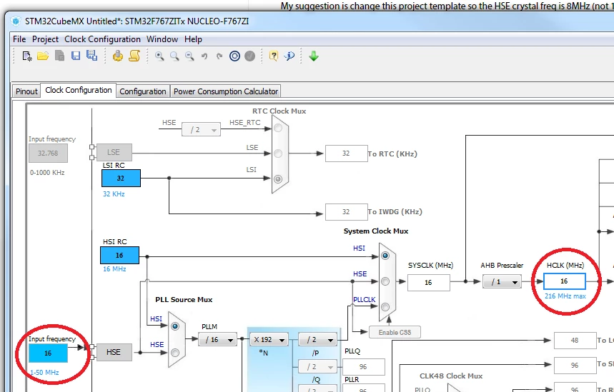

If you create a Cube project using the NUCLEO-F767ZI board template, it uses 16MHz for the HSE crystal.
Out of the box, from the user manual, the dev board uses the:
MCO from ST-LINK (Default): MCO output of ST-LINK is used as input clock. This
frequency cannot be changed, it is fixed at 8MHz and connected to the
PF0/PH0-OSC_IN of STM32 microcontroller. The configuration must be:
– SB148 OFF
– SB112 and SB149 ON
– SB8 and SB9 OFF
This minor issue will probably get a few users scratching the heads like me when they cant get the correct baud on uart or other. But this is the only NUC/Disco board i have used where the template doesn't work for out-of-box boards.
My suggestion is change this project template so the HSE crystal freq is 8MHz (not 16).
I am using Cube 4.22.1
Also, less of a gotcha, is the overall board target frequency in the template, is for 16Mhz, and probably most users want to go for the full 216Mhz the first time they use it.

    Posted on April 23, 2018 at 18:18
    Hi John,
    It has been fixed in the 4.25.0, Please update to have the fix
