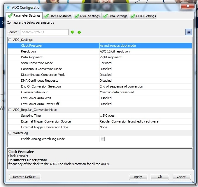

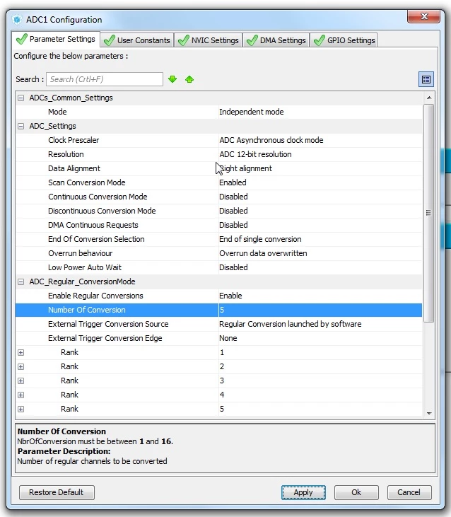

Posted on July 05, 2018 at 11:39
...seems not selectable in CubeMX (V4.26.0).
Does F091 not allow for ADC scan sequences?
We have successfully used F303 in this manner (multichannel, even different sampling times).
Juergen

    JuM
    JuMAuthor
    Senior
    July 6, 2018
    Posted on July 06, 2018 at 11:01
    Ok, understood. No ranking for STM32F0, sequence is fixed (up or down), all with sample rate. Thank you.
