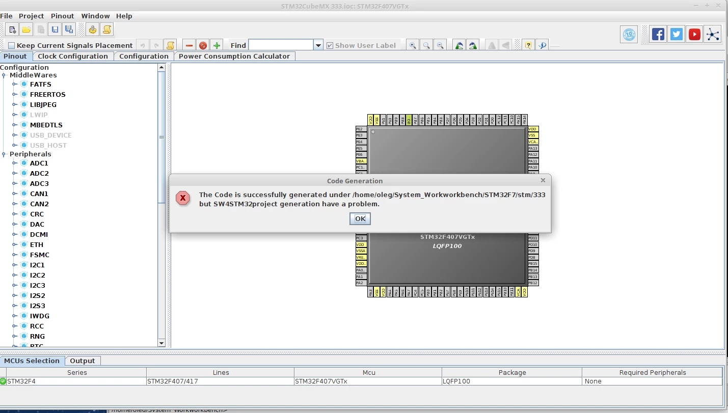

Hello guys! Help me please... I have problems with the CubeMX, can not generator code create project((( Operating system Linux Mint 18

    Dec 21, 2017 3:09 PM UTC
    Posted on December 21, 2017 at 16:09
    Could you please provide more details about the  version used?
    Please ensure to use the last CubeMx version.
    Best Regads
    Imen

    Especially version and state of Java being used.

    Dec 21, 2017 7:16 PM UTC
    Posted on December 21, 2017 at 20:16
    Hello!
    java -version
    java version '1.8.0_144'
    Java(TM) SE Runtime Environment (build 8.0.5.0 - pxa6480sr5-20170905_01(SR5))
    IBM J9 VM (build 2.9, JRE 1.8.0 Linux amd64-64 Compressed References 20170901_363591 (JIT enabled, AOT enabled)
    J9VM - d56eb84
    JIT - tr.open_20170901_140853_d56eb84
    OMR - b033a01)
    JCL - 20170823_01 based on Oracle jdk8u144-b01
    STM32CubeMX version 4.23

    Dec 21, 2017 9:06 PM UTC
    Posted on December 21, 2017 at 22:06
    guys, isolved the problem. Reinstalled java 8, for some reason not enough one dependencies
    Now working good!Has also installed new program from STM STM32CubeProgrammer, now all works on Linux!
    Thanks a lot, dear

    new version Java 8:
    java version '1.8.0_151'
    Java(TM) SE Runtime Environment (build 1.8.0_151-b12)
    Java HotSpot(TM) 64-Bit Server VM (build 151-b12, mixed mode)
