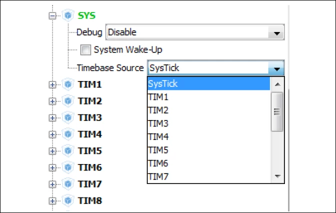

Hello
I'd just like to know why CubeMX strongly recommends to use other timers besides SysTick as source? I've always thought that the SysTick timer is basically intended for use with an embedded OS?
Thanks

    Hi see.juan,
    As mentioned is the UM1718 ?STM32CubeM user manual:
    By default, the STM32Cube HAL is built around a unique timebase source which is the ARM-Cortex system timer (SysTick).
    However, HAL-timebase related functions are defined as weak so that they can be overloaded to use another hardware timebase source. This is strongly recommended when the application uses an
    RTOS, since this middleware has full control on the SysTick configuration (tick and priority) and most RTOSs force the SysTick priority to be the lowest.
    Using the SysTick remains acceptable if the application respects the HAL programming model, that is, does not perform any call to HAL timebase services within an Interrupt Service Request context (no dead lock issue).
    To change the HAL timebase source, go to the SYS peripheral in the IP tree pane and select a clock among the available clock sources: SysTick, TIM1, TIM2,...?
    So you can select a HAL timebase source (STM32F407 example) as follow: ( note that the selected timer will be grayed and can no longer be selected)

    Posted on March 31, 2016 at 12:55
    Thank you very much!
    I'd recommend to add a hint to the pop-up warning within CubeMX, instead of just flashing the warning without any further information. Also I find the message to be slightly misleading.
    ''It is strongly recommended to use a timebase source other than the Systick when FreeRTOS is used. The timebase source can be changed from Pinout tab under SYS.''
    That reads as if the timebase source for FreeRTOS gets changed by that option in the SYS tab, not the timebase for HAL.

    Thanks for the explaination and reference to the user manual, it is greatly appreciated.
    I still have one question though : what timer should I select? In the UM, there are screenshots showing TIM2 selected. But is there any reason to select one time over the other for a very simple code?
    Thanks for your help

    Hi de_wolf.christophe,
    There is no restriction . Any timer can be used in addition to systick possibility.
