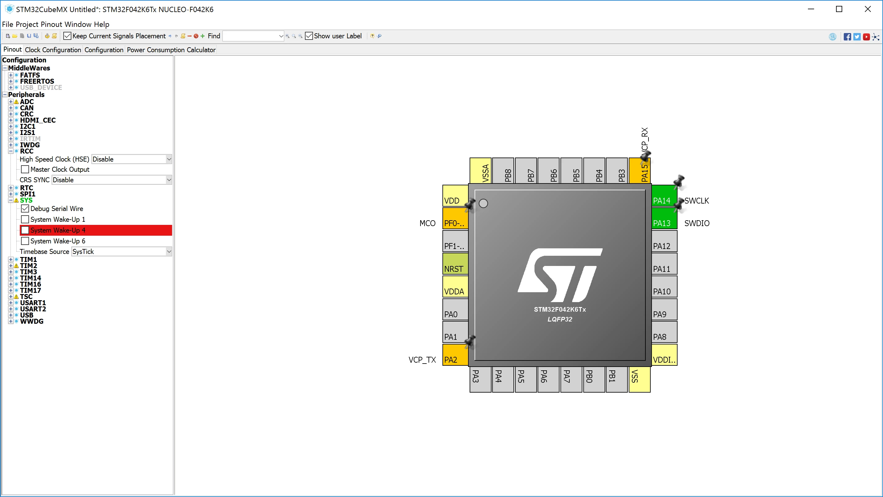

Using recently updated (app and all libraries) CubeMX v4.21.0 on Windows 10, I create a new project for the NUCLEO-32 (STM32F042K6T6) board, but there are no settings for configuring the GPIO pins.

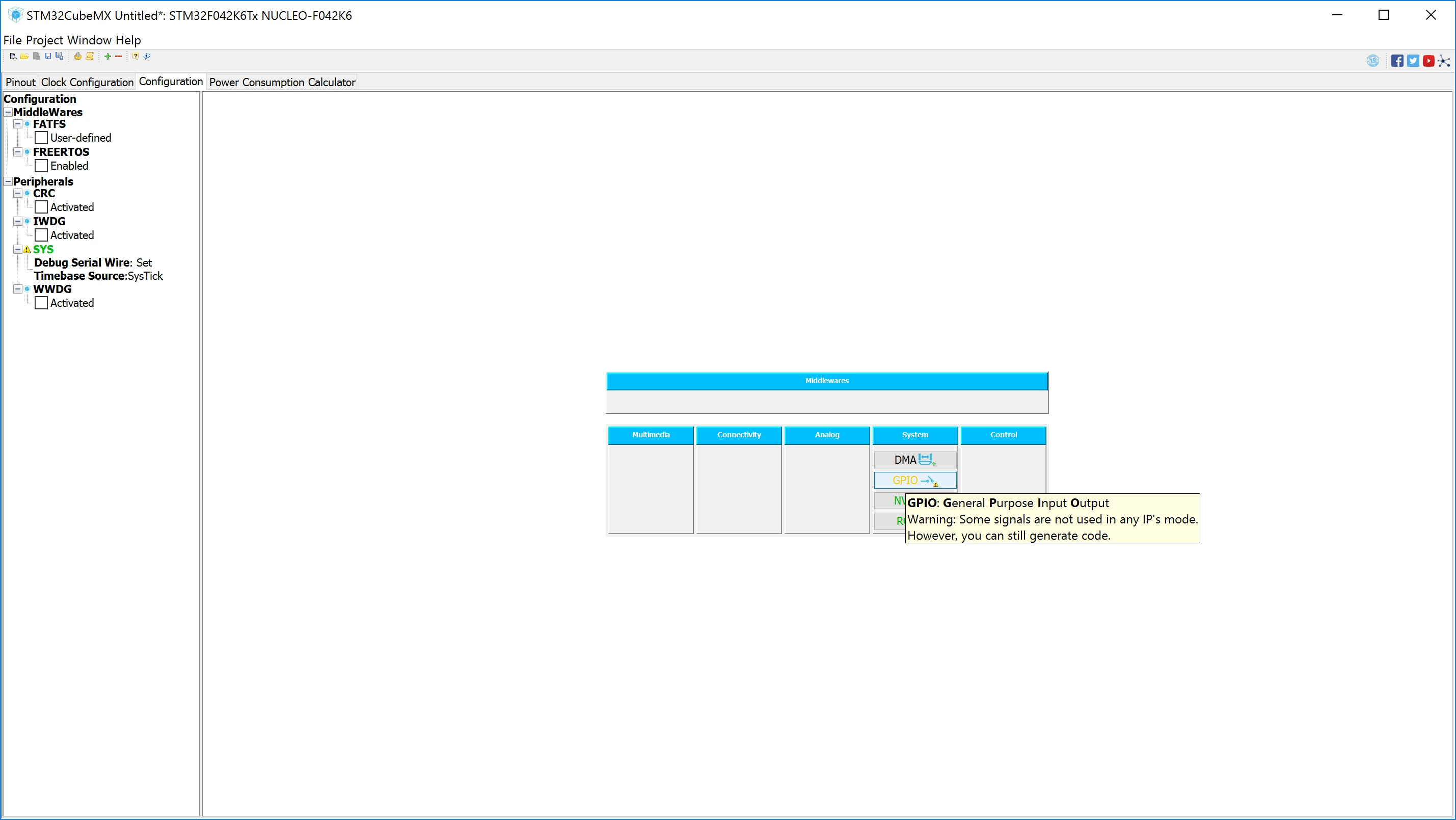

When I go to the 'Configuration' tab, the GPIO section is highlighted in yellow and gives the following warning when I hover the mouse pointer over the 'GPIO' button:
'Warning:  Some signals are not used in any IP's mode.  However, you can still generate code.'
Am I missing something obvious?
Please see attached screen captures.  Also, I'm still disappointed that the latest updates to not address the 'tiny icon' problem on UHD-4K screens.

    Hi
    Wheat.Dale
    I checked that there is the same behavior with previous CubeMX version.
    I reported the GPIO related warning to our MX team in order to take it into consideration and avoid confusion (with a reminder for
    https://community.st.com/0D50X00009XkfPjSAJ
    -Amel

    Hi
    Wheat.Dale
    Whenever CubeMx projet is created at first, depending on predefined configuration files in internal database of CubeMx tool, some pins a pre-configured for possible IP usage.
    If these pins are not affected to a 'Peripheral' mode of the 'Pinout' tab of UI, it brings the warning in the 'Configuration' tab of the UI.
    If you don't plan to use the pin at all, just simply select default value for the pin in the contextual checkbox; since the 'Peripheral' mode is not used, there will be not need of configuration at all for the pin and the warning is going to disappear in the 'Configuration' tab of the UI.
    Hopping it clarifies the behavior of the tool.
    Regards
    Cyril
