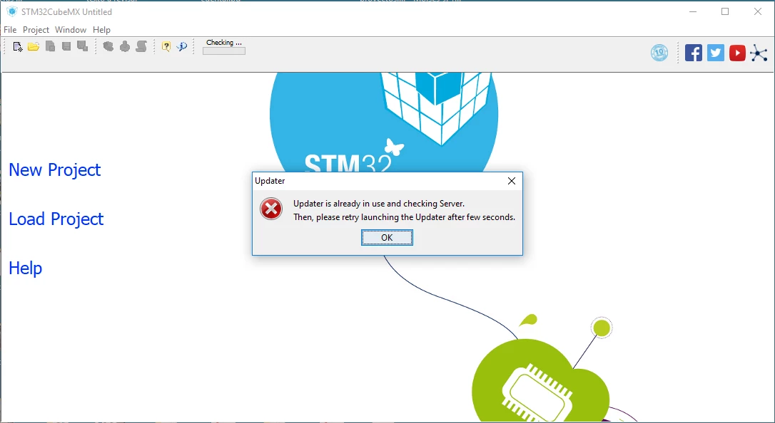

CubeMX pop up the message 'updater is already in use and checking server. Then please retry launching the Updater after few seconds'. It has been always checking and nothing updated. Because of that issue, there is no firmware available and it can't generate source code.
How to fix that issue?

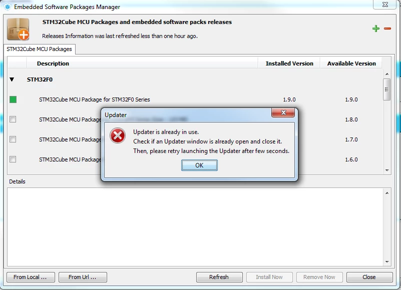

    This window
    brings
    out when the updater is checking for update (or working
    in
    the background
    ) and you want to change for example the configuration of your proxy. In that case, a pop up window appear. For example, I had
    succeeded
    to reproduce yo
    ur issue
    by
    • New project CubeMX (load mcu)
    • Help ----> Manage embedded software packages
    • Help ----> Updater setting
    ===> the window appear

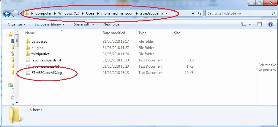

    Please let me know about the steps you followedto get this issue. I
    t will be more helpful if you can send me your log file (C:\Users\xxxxx\.stm32cubemx\STM32CubeMX.log)
    Please do not hesitate to contact me for further details.
    Best Regards,
    Mohamed.

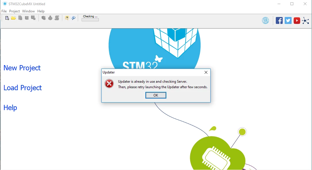

    moises Reyes
    Visitor II
    May 31, 2018 4:16 PM UTC
    Posted on May 31, 2018 at 16:16
    Hi Mohamed,

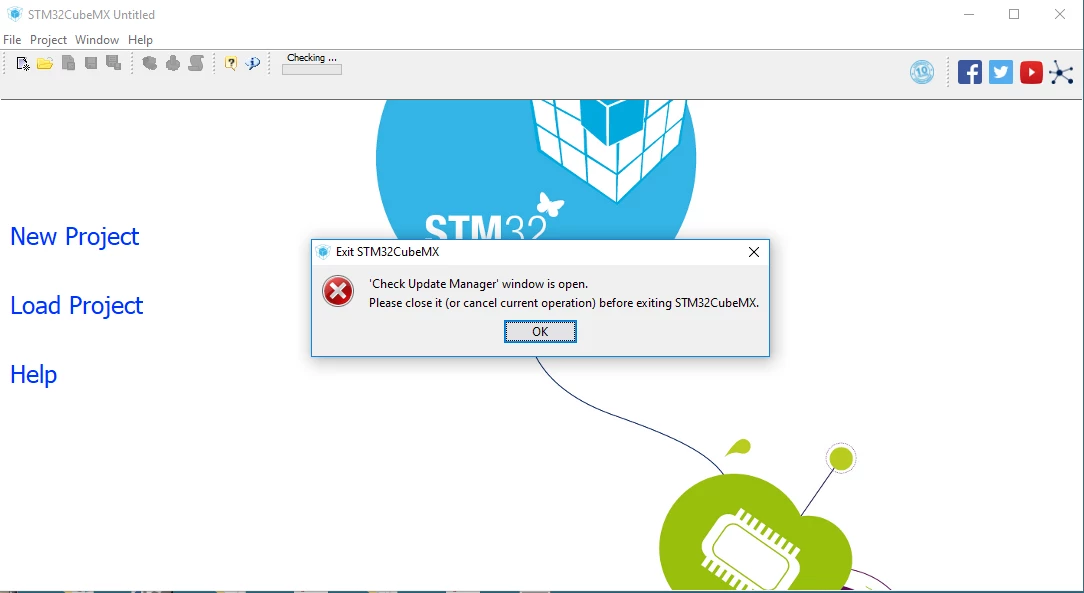

    i just installed the software and i am facing the same issue from the very beginning. I mean, at the moment that the STMcubeMX software (version 4.25.1) is opened, the process 'Checking for updates' starts automatically with and stays there for ever.
    I can't even close the software properly because this message 'updater is already in use and checking server. Then please retry launching the Updater after few seconds' appears.
    Also my PC starts to freeze.
    OS version: Windows 10 Home, 64-bits.
    STM32cubeMX version: 4.25.1
    I appreciate any help to solve this issue.

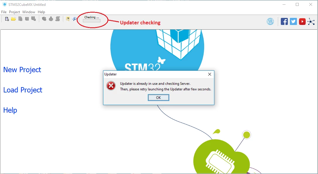

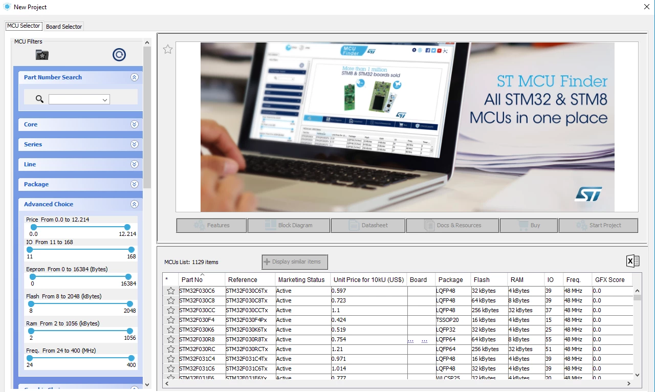

    I took some screenshots to show you what is going on.
    At start STM32cubeMX software version 4.25.1. It is not possible to disable the automatic update search. When i try to click on ?Updater Settings? appears the message ''updater is already in use and checking server. Then please retry launching the Updater after few seconds''.
    This appears when i try to close the software.
    This appears when i click on ''new project'' option. This is very strange, because obviously i have a internet connection and i have added an exception in my firewall (just in case).
    After i click on ''yes'' appears again the same message.
    This situation happens two times and then i have access to this screen, but after 5 minutes it is impossible to work. My pc is absolutely frozen.
    As you can see in the next screenshot, i have no .log file to share.

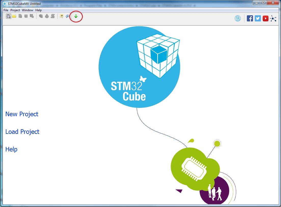

    I'm glad to hear that it's working for you both.
    As an information, when you open CubeMX, the updater will check automatically the new updates. and here is updater job in background.
    So, that's why when you try ,for example to change the updater setting, a pop up message appears. It's recommended to let the updater finish his checking until you get this new view below.
    Finally, you can check your log file under this directory: C:\Users\mohamed mansouri\.stm32cubemx
