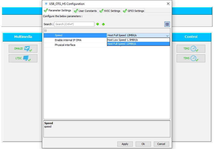

CubeMX Bug Report: Missing HCD_SPEED_HIGH option
  • July 2, 2016
  • 3 replies
  • 1009 views
Posted on July 02, 2016 at 09:05
I have a project using the STM32F429 MCU with USB_OTG_HS, USB_HOST, and FatFs enabled. When configuring the  USB_HS peripheral in the Configuration tab, the CubeMX tool offers only Low and Full Speed as setting options - see attached screenshot. But according to UM1720 ''STM32Cube USB host library'' manual, section 6.4.3 (page 41), hhcd.Init.speed can be one of HCD_SPEED_FULL or HCD_SPEED_HIGH.
Comments?
Thanks for your attention.
Best regards,
T. Todorov

    Posted on July 04, 2016 at 21:10
    In the document ''RM0090 - Reference manual (DM00031020.pdf)'',
    section ''35.2.1 General features'' says:
    The OTG_HS interface main features are the following:
    - It is USB-IF certified in compliance with the Universal Serial Bus Revision 2.0
      Specification
    - It supports 3 PHY interfaces
    An on-chip full-speed PHY
      – An I2C Interface for external full-speed I2C PHY
    An ULPI interface for external high-speed PHY
    The above text may clarify the problem.

    Hi T. Todorov,
    Which CubeMX version are you using? If you are using an old version, I recommend you to use the latest: 4.15.1
    -Syrine-

    Posted on October 07, 2016 at 18:30
    Dear Todor,
    The issue is fixed in 4.
