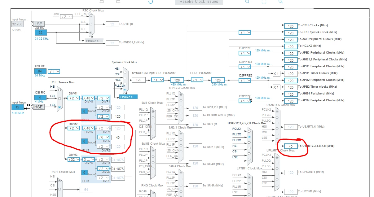

USART2 is the only one using PLL2.
Because it is the only peripheral using PLL2, there is no PerpheralCommonClockConfig. The Clock is initialized within HAL_UART_MspInit:

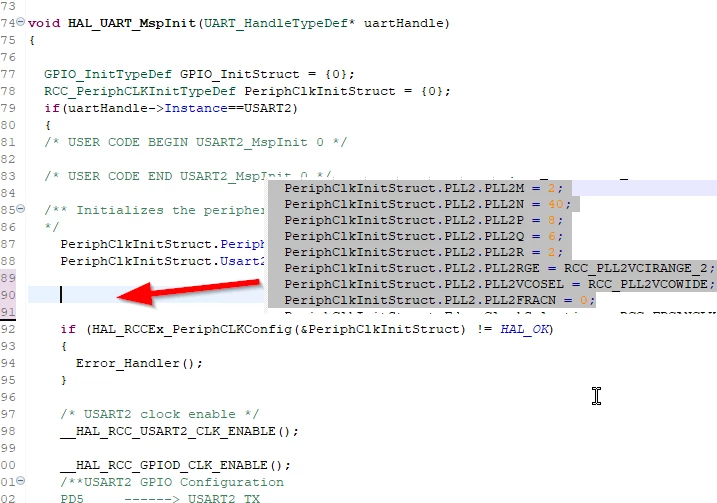

void HAL_UART_MspInit(UART_HandleTypeDef* uartHandle)
 RCC_PeriphCLKInitTypeDef PeriphClkInitStruct = {0};
 if(uartHandle->Instance==USART2)
 /* USER CODE BEGIN USART2_MspInit 0 */
 /* USER CODE END USART2_MspInit 0 */
 /** Initializes the peripherals clock
 PeriphClkInitStruct.PeriphClockSelection = RCC_PERIPHCLK_USART2;
 PeriphClkInitStruct.Usart234578ClockSelection = RCC_USART234578CLKSOURCE_PLL2;
 if (HAL_RCCEx_PeriphCLKConfig(&PeriphClkInitStruct) != HAL_OK)
 Error_Handler();
 /* USART2 clock enable */
 __HAL_RCC_USART2_CLK_ENABLE();
 __HAL_RCC_GPIOD_CLK_ENABLE();
The clock configuration for PLL2 is missing all settings for the prescalers and PLLs

Back to the version from before, USART2 being the only one using PLL2
If I add this piece of code manually:
Then the UART gets the correct clock and is working fine.
