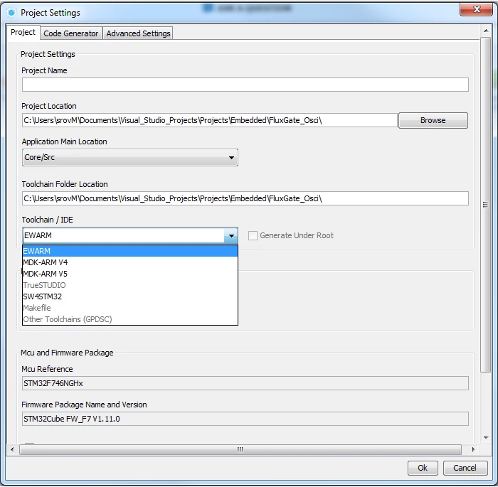

cubemx 4.25.1 project settings GPDSC toolchain is not highlighted
Posted on June 01, 2018 at 11:07
I'm working on a STM32F7 project nad like to imporz it ot VisualGDB. I have to generate a *.GPDSC file, but the button is not higliehgted in CubeMX. How I get it highlighted?0690X0000060L41QAE.png

    I think you are usingSTemWin in your project?
    In fact, theTrueStudio, Makefile and Other (GPDSC) toolchains are not supported with STemWin feature and are grayed out in the user interface.

    Thanks Imen,
    it what was happens. Withput STemWin I can create GPDSC
