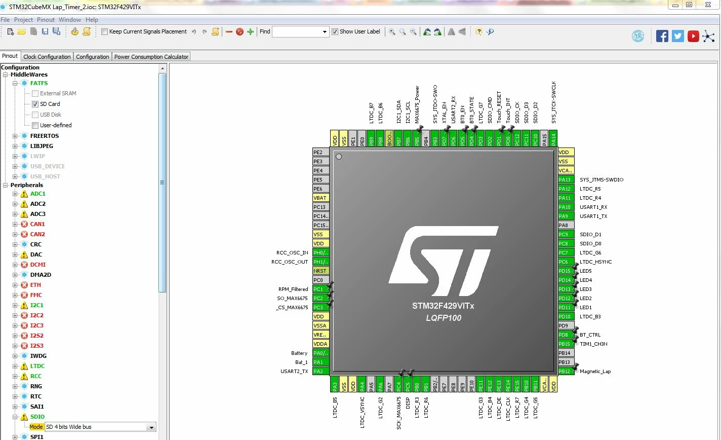

Hi, I'm currently trying to make SD card work with FatFS on a custom made PCB with STM32F429. I create the init files with CubeMX 4.22.1 and although I set the SD interface to be 4 bits long, I find this code in the stm32f4xx_hal_sd.c
/* Default SDIO peripheral configuration for SD card initialization */
  Init.ClockEdge           = SDIO_CLOCK_EDGE_RISING;
  Init.ClockBypass         = SDIO_CLOCK_BYPASS_DISABLE;
  Init.ClockPowerSave      = SDIO_CLOCK_POWER_SAVE_DISABLE;
  Init.BusWide             = SDIO_BUS_WIDE_1B;            // <--- shouldn't this be SDIO_BUS_WIDE_4B ????????
  Init.HardwareFlowControl = SDIO_HARDWARE_FLOW_CONTROL_DISABLE;
  Init.ClockDiv            = SDIO_INIT_CLK_DIV;
Also, the same thing  appears in MX_SDIO_SD_Init function created by CubeMX in main.c

I'm asking this because HAL_SD_ConfigWideBusOperation (found in bsp_driver_sd.c) fails with error despite correcting these 2 mistakes, so I wonder if more mistakes are present that prevent SD card from initializing correctly.
