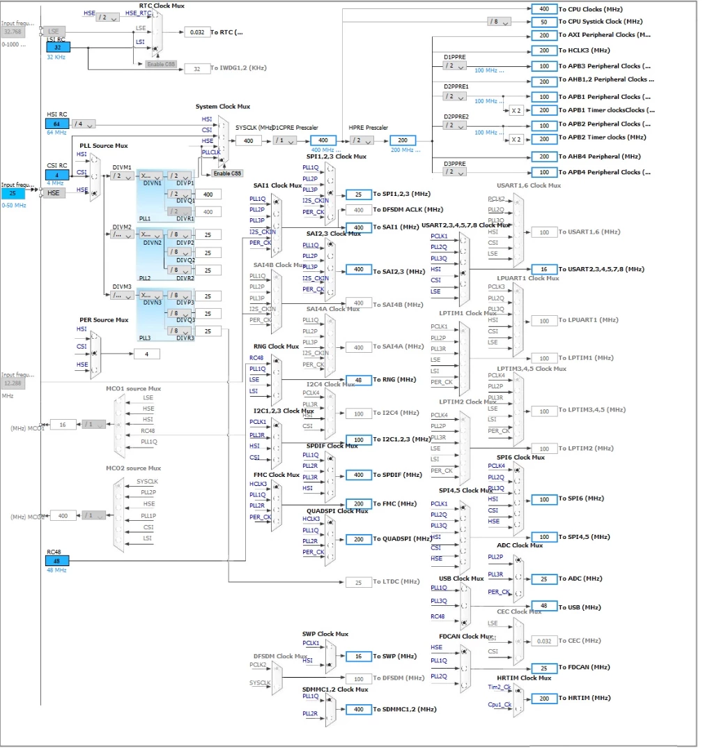

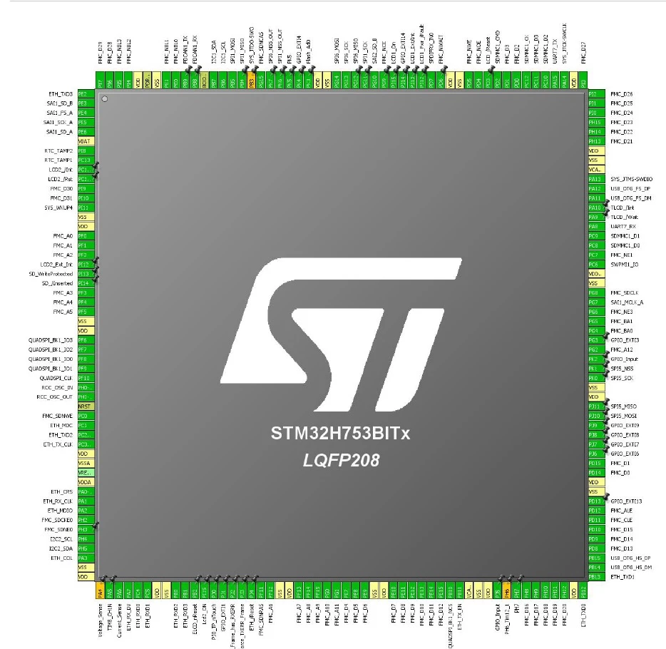

    T J
    Senior III
    March 27, 2018
    Posted on March 28, 2018 at 01:15
    its a question of complexity.
    the complexity is squared for the chip size.
    ie, LQFP 32   STM32F103, its an easy enough job by hand,
    but when you have 176-240 pin STM32F7 I would guess it is extremely difficult by hand,
    but don't forget the PCB.
    I would say, from scratch, its very unlikely that you would be able to design a high density working board without the cube.
    I use the cube to make my PCBs and then the initialisation code comes up and we get to while(1);
    did you see the range of clock options inside the H7 part ?
    very difficult to set the clock configuration without the cube.
