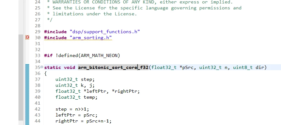

Hi :
      I updated  STM32CubeIDE a few hours ago.
Version: 1.15.0
Build: 20695_20240315_1429 (UTC)

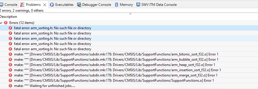

Now it will failed at the SystemClock_Config() and missing arm_sorting.h

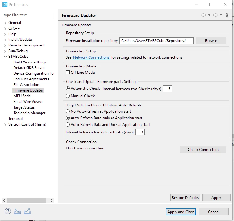

                          Sure, do you need the whole file in zip? FYI I, installed the Cube IDE Version: 1.15.0 in another new laptop, and it has the same problem. But with the same laptop installed with the earlier version, the project ran without error.  Please let me know how to share the project.
Best Regards.

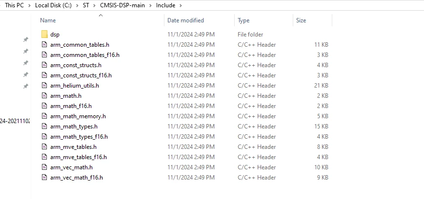

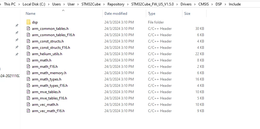

I don't see any  "arm_sorting.h" at both folders.
"dsp/support_functions.h" yes, the support_functions header file is in both folder.
is this what you are looking for?

Mar 26, 2024 10:53 AM UTC
@STTwo-32 :
                     You have mentioned earlier regarding something about the path:
here is the link:
https://github.com/ARM-software/CMSIS_5/issues/910
below is the comment:
"You need to include the folder DSP/PrivateInclude when building.
This folder contains headers that are used only for building the libraries but not to use it.
The other folder DSP/Include is for headers which are needed to use the library. "
I can locate the arm_sorrting.h header files as mentioned in the link.
You did mentioned about path, build path ? if yes where can I check and probably change it?
Best Regards
