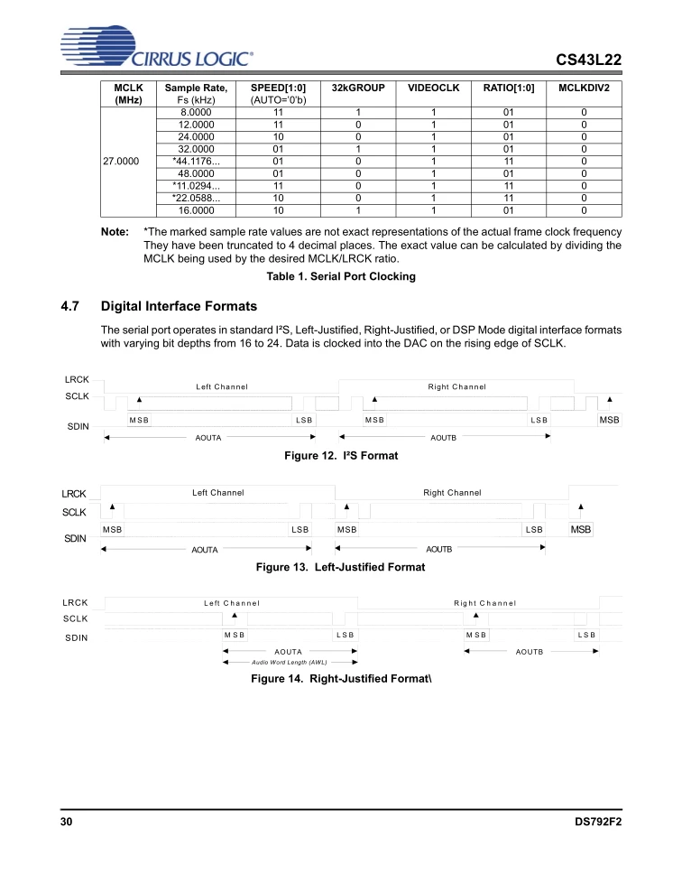

Can anyone help me with using the codec CS43L22 in analog passthrough mode on STM32F4-Discovery.
Flow of application
Analog Input ---> ADC ---> DAC ---> CS43L22 ---> Headphone or Speaker
I have got ADC and DAC working, but the codec is not working.

    CS43L22 *is* a DAC, so you want
    Analog Input ---> ADC ---> [data in processor] --->[I2S]---> CS43L22 ---> Headphone or Speaker

    CS43L22 requires data in PCM format. I'm recording audio over an external microphone and need to transfer as analog data to codec.

    This looks pretty much I2S to me.
    PCM is just to say that ''amplitude samples are taken regularly'' (as opposed to other forms of modulation, for example delta-sigma).

    I've made my CS43L22 Passthrough worked: provide MCLK by calling 'HAL_I2S_Transmit_DMA' even we do not use I2S audio data.
