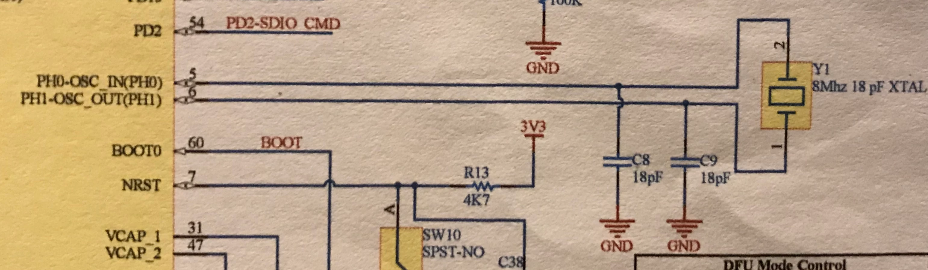

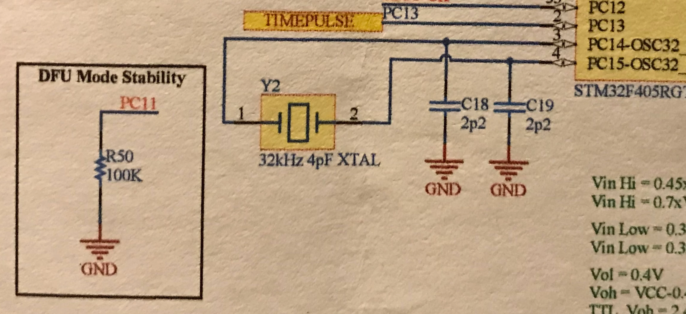

I have designed in the following oscillators:
  1. ABM7-8.000MHZ-DY2-T for the high speed oscillator 18pF
  2. ABS07-120-32.768KHZ-T for the low speed oscillator 6pF
Will these two crystals work in this configuration?
