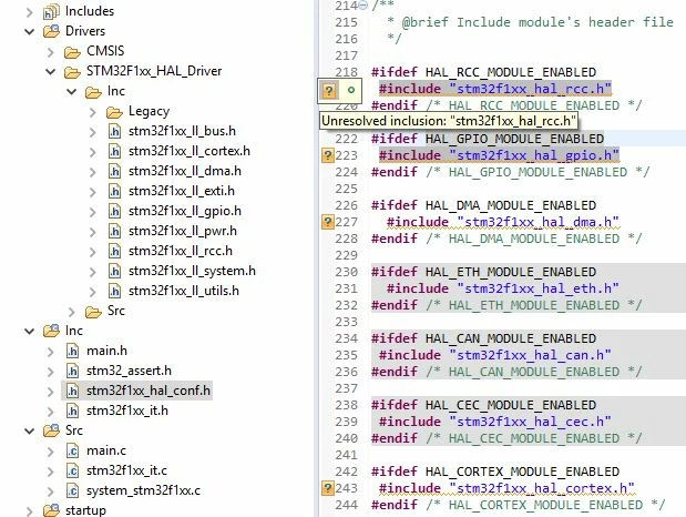

    As an addition to the second question about including HAL drivers instead of LL drivers: a screenshot
    No doubt I'm doing something wrong, but I can't find what....

    Hello
    Lunenburg.Wilko
    I want to thank you for your issues report.
    The issue for LL GPIO pins is already confir
    med and will be fixed in the next release.
    https://community.st.com/0D50X00009XkYowSAF
    About
    including HAL drivers instead of LL drivers, Iwill check and raise internally your feedback.
    Best Regards,
    Imen

    Thanks Imen, I solved it this way by adding this to MX_GPIO_Init
    RCC->,APB2ENR |= RCC_APB2ENR_IOPCEN, , ,  , , ,  , , ,  , , ,  , , ,  , , , , //enable APB2_clock GPIOC
    GPIOC->,CRH |= GPIO_CRH_MODE13_1, , ,  , , ,  , , ,  , , ,  , , ,  , , ,  , , ,  , , ,  ,//PC13 output
    GPIOC->,CRH &,= ~GPIO_CRH_CNF13, , ,  , , ,  , , ,  , , ,  , , ,  , , ,  , , ,  , , ,  , , ,  ,//PC13 push pull
    And by changing the stm32f1xx_hal_conf.h like this:
    ♯ ifdef HAL_RCC_MODULE_ENABLED
     , ♯ include 'stm32f1xx_ll_rcc.h' , , , , , , , , , , , , , , , , , , , , , , , , , , , , , , , , , , , , , , , , , , , , , , , , , , //changed from _hal_ to _ll_
    ♯ endif /* HAL_RCC_MODULE_ENABLED */
    ♯ ifdef HAL_GPIO_MODULE_ENABLED
     , ♯ include 'stm32f1xx_ll_gpio.h'
    ♯ endif /* HAL_GPIO_MODULE_ENABLED */
    Kind Regards,
    Wilko
