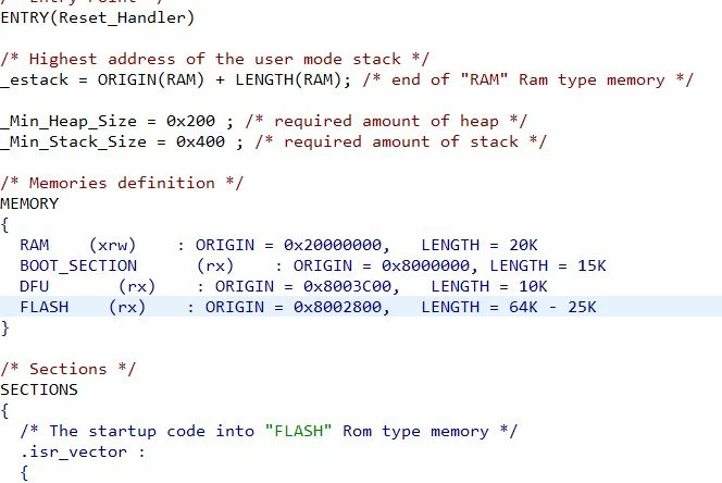

Creating memory sections
Hello everyone once again, i am trying to split the main flash memory (just by using the .ld file) to put in each one a specific code (bootloader, DFU, app), i did what you can see in the image below, but i am not sure why the DFU and FLASH sections are not empty...do i left something else to do?
They are not empty:
0693W00000QLjOiQAL.jpgThanks in advance

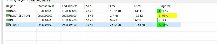

The Memory Details tab could help...
hth

It is easier, more robust and flexible to create a bootloader as a completely separate project, including the linker script.
