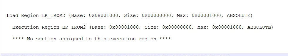

    when I check the .MAP file I see
    Load Region LR_IROM2 (Base: 0x08001000, Size: 0x00000000, Max: 0x00001000, ABSOLUTE)
    Execution Region ER_IROM2 (Base: 0x08001000, Size: 0x00000000, Max: 0x00001000, ABSOLUTE)
    **** No section assigned to this execution region ****
    So I am not adding the structure to this region right? How do I place the structure into this LR_IROM2 region? I tried __attribute__((section('name'))) which is equivalent to #pragmas but failed to place it in that region. How should I match the 'name' of section inside attribute to that in scatter file so that it gets reflected in .MAP file? I think I am going wrong in this step.

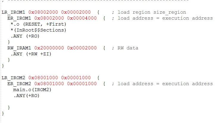

    I accidentally put the wrong screenshot of the scatter file I was trying on another keil project. I did try again to confirm and it's the same result. I am starting to wonder if I have to make any changes in Linker settings
    static const char sig[] __attribute__((section(''IROM2''))) = ''IROM2 Signature'';

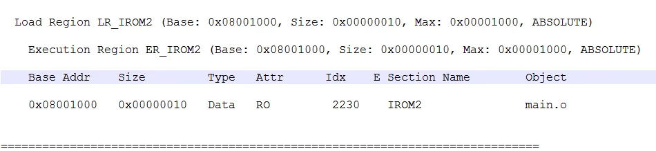

    Finally,
    Had to add --keep=''main.o(IROM2)'' in Options>Linker>Misc controls section
    For some reason the linker removes the section. Now I am able to see the data in IROM2.
