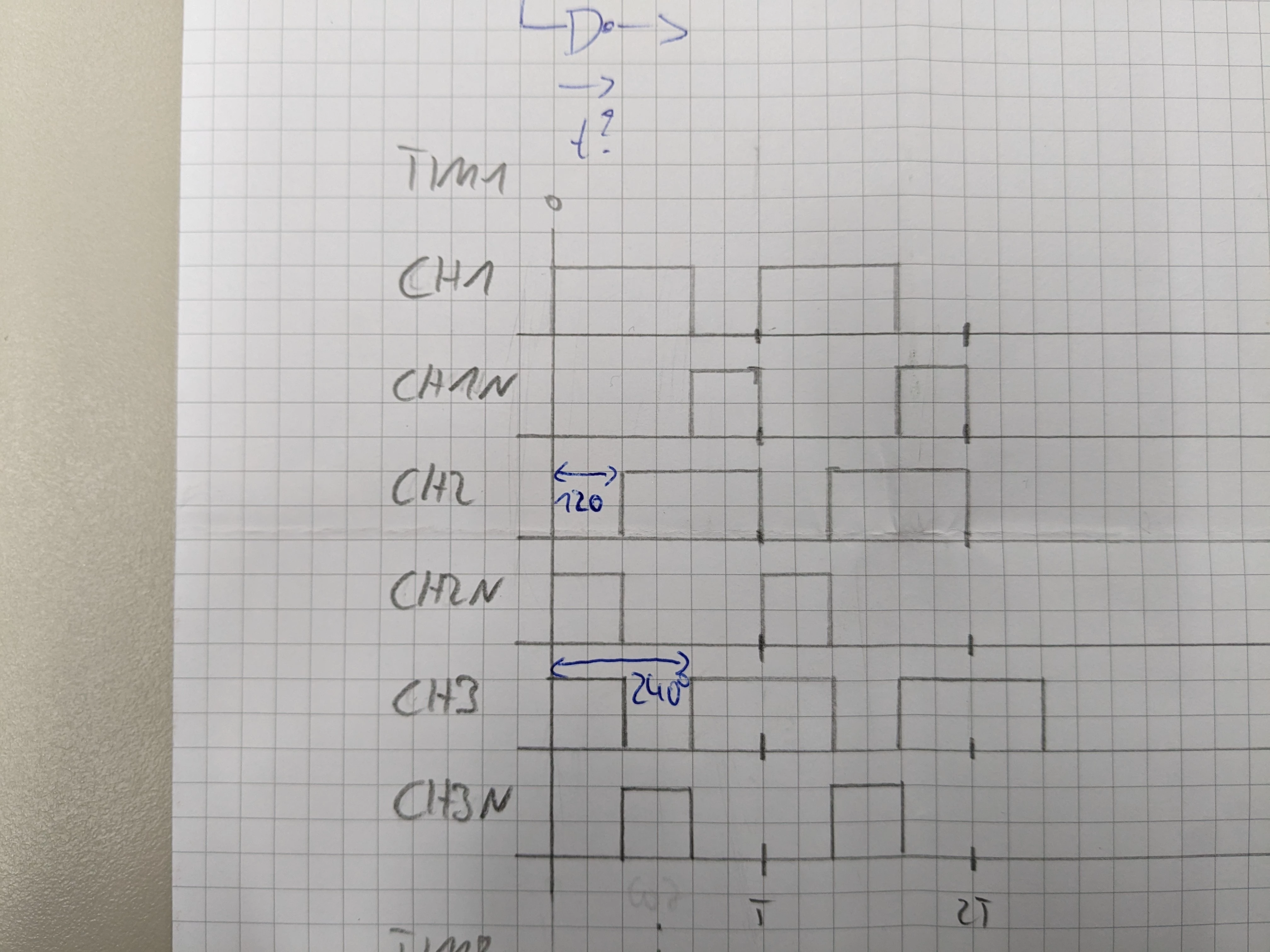

I'm using a NUCLEO-G431KB to create the PWM signals.
I need to have 3 PWM signals plus their complementary outputs with same pulsewidth and a phaseshift of 120° between them, see picture below.
In the video Hands-On with STM32 Timers: Internal Triggering System, three timers are used via master-slave mode to get this done.
Is it possible to create these three signals with one Timer, for example TIM1 and use CH1-CH3 and their complementary outputs?
Thanks!

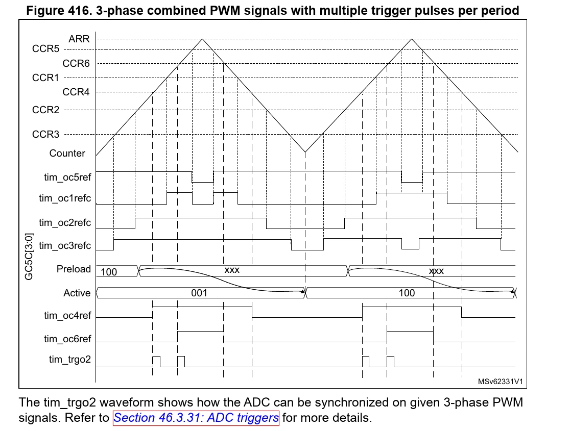

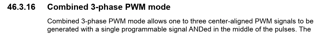

AScha.3
January 5, 2023
maybe - this is, what you can use:
