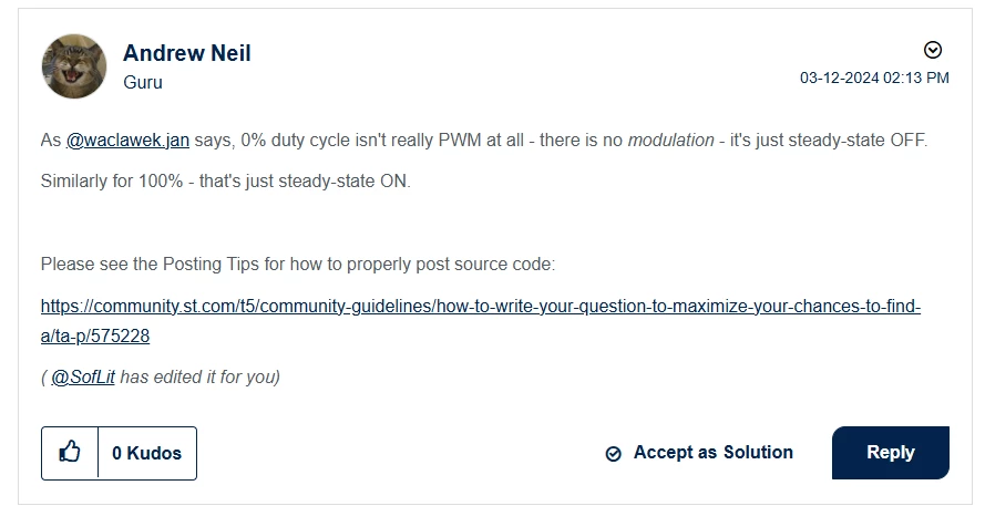

Hello @saurabhkore ,
Please use </> button to paste your code. See tips on posting here. I'm editing your post.
Already suggested to you to follow that tips on code posting:
Thank you for your understanding.
