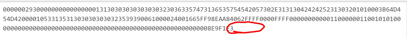

Perhaps try it with only 2-3 bytes first. Going to be a lot easier to work with.
The link you shared doesn't have the last few zero bytes on it.

Aug 25, 2023 7:15 AM UTC
Sorry, your rigth, the correct Data in code is without the last 2 bytes 0x00, 0x00.
Remaking the calcs, the new value that i get is 0x1A80 with XOR 0xFFFF applied and its still wrong.

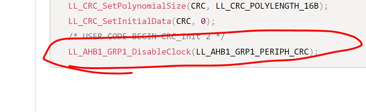

> LL_AHB1_GRP1_DisableClock(LL_AHB1_GRP1_PERIPH_CRC);
This disables the CRC clock. Don't do that until you're done with it.

Aug 25, 2023 7:21 AM UTC
I dont disable the clock until i have finished the calcs.
This disables the clock after initialization, no?
Dosan
DosanAuthor
Aug 28, 2023 5:41 AM UTC
Yes, i disable the clock to get better power consumption, but when i use the CRC is enable.
