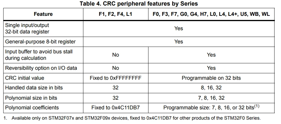

Senior
October 13, 2023
Hi @Tesla DeLorean,
1.So it's using the default 32-bit polynomial?-------I think so, not sure.
I am using STM32G4 series .As per CRC application note below tables says polynomial coefficient is programmable. Based on what basis do I need to select polynomial coefficient can you suggest.
I saw some posts in forum they are using below polynomial. Can you suggest how do select value for  polynomial?
1.#define MODBUS_CRC_POLY 0x8005
2.#define MODBUS_CRC_POLY 0xA001
If I define my polynomial below configuration are sufficient?
hcrc.Init.GeneratingPolynomial = MODBUS_CRC_POLY;
hcrc.Init.CRCLength = CRC_POLYLENGTH_16B;
hcrc.Init.InitValue = 0xFFFF2.
3.My application is to send the data of  sensors and status of some sensors  to other module using UART. That module receives the data and send it to cloud.
