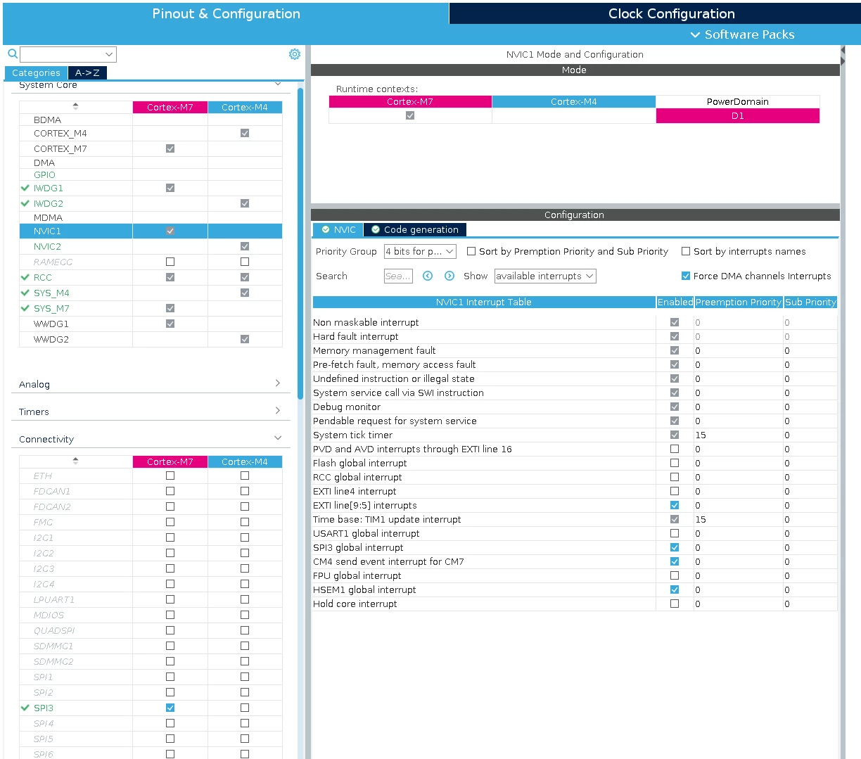

Hello and welcome to the forum!
So you want to erase a sector in the internal flash of STM32H755.
SPI is not related to this so there's no any sense in enabling its interrupt (and what is "SPI interrupt source" at all?)
Remove or comment out lines 24, 27. Will it work?
armdudeAuthor
Jan 14, 2025 6:59 PM UTC
Ah sorry for not providing the context for the SPI. For our project, the SPI is used to communicate with an EtherCAT slave controller subsystem to it is required. The code above for initializing the SPI interrupts are from our vendor BSP.
Commenting our lines 24,27 does indeed work and does not cause the MCU to hang.

armdudeAuthorBest answer
Jan 14, 2025 8:59 PM UTC
Okay I did some more testing and realized that the init function from our BSP was enabling the SPI interrupts BEFORE the SPI peripheral was initialized. My guess is that an interrupt was being fired as soon as the SPI interrupts were enabled and because the SPI peripheral wasn't even initialized yet, it caused the CPU to hang. So I guess the lesson is don't blindly trust your vendor BSP's init functions.
