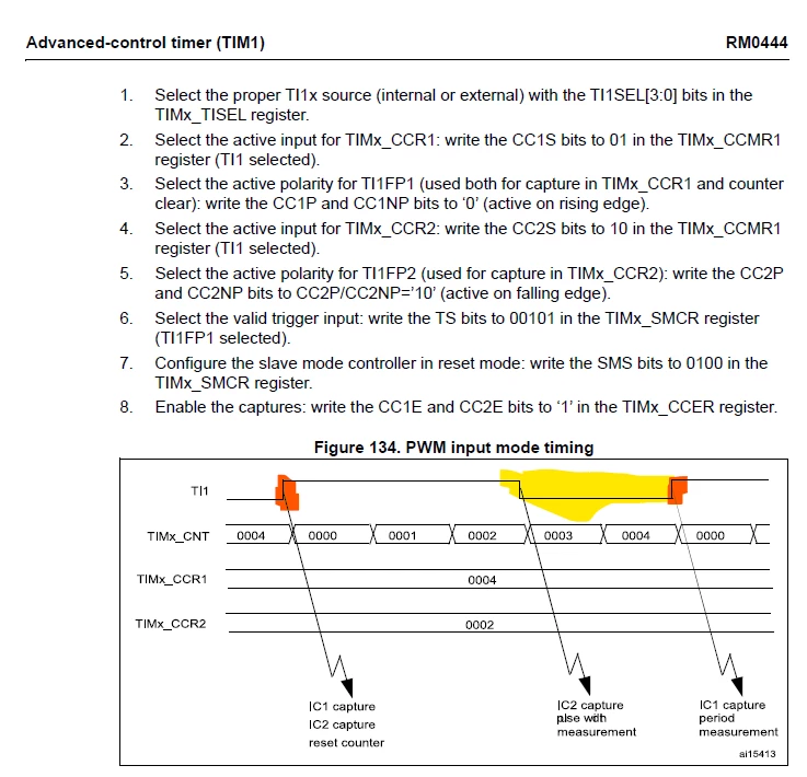

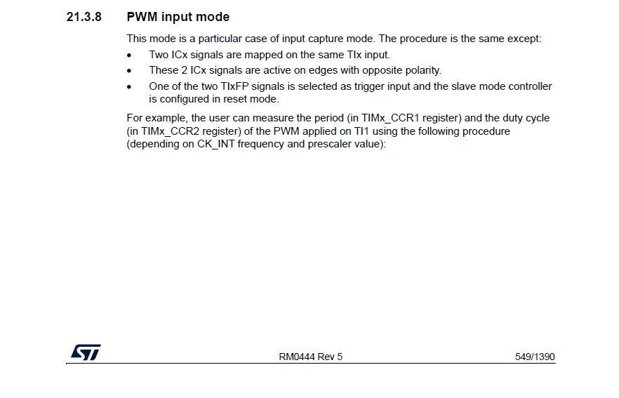

Have you investigated the following method for your application.
In my view it is better to use one Timer(Like Timer 2) as a Trigger input into another Timer.
To use Timer 2 in PWM Input Capture mode, can do the period measurement between the pulses, the rising edge of the pulses which will serve as a Trigger input into Timer 2 and update the counter much like the Sketch below which is in the reference manual.
The red I highlighted will count your pulses and those red events is when the counter is RESET.
So the reset counter can serve as a trigger input into another timer. The yellow is the time between your pulses. You can also set this up with DMA, and this will then DMA the value of your Counter at an IC1 Capture Period Measurement.
I think this is easier.
