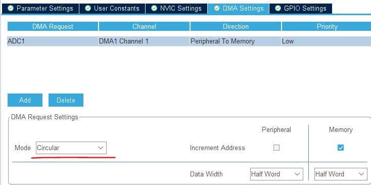

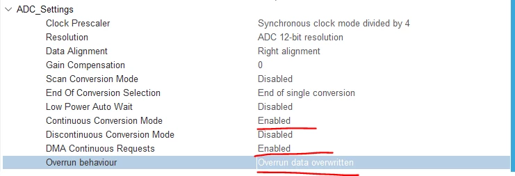

You can use a DMA request. The ADC is capable of generating this request to notify the DMA of the end of the conversion. The best way to use the DMA with the ADC is in continuous mode, with a DMA destination (a variable in memory), so that the user can use this variable without worrying about when it is updated by the ADC. When the ADC completes the conversion, it generates a request to the DMA, which copies it into this variable. Since continuous mode is enabled and the DMA is in circular mode, all the previous steps will restart automatically.
Here is the necessary configuration for this behavior:
For starting the ADC with DMA and specifying the destination variable, you could use:
if (HAL_ADC_Start_DMA(&hadc1, (uint32_t *) &VARIABLE_DESTINATION, 1) != HAL_OK)

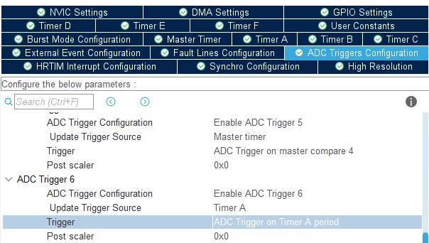

To generate a 500 ns PWM, you need to program and activate a counter with: HAL_HRTIM_WaveformCounterStart_IT(&hhrtim1, HRTIM_TIMERID_TIMER_A); / HAL_HRTIM_WaveformOutputStart(&hhrtim1, HRTIM_OUTPUT_TA1) for example, and generate a trigger to the ADC by this Timer unit, you can program the trigger at the beginning of the period:

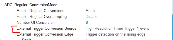

Then on ADC side, you need to bind this trigger to conversion source, so ADC will start working when triggered by hrtimer period:
