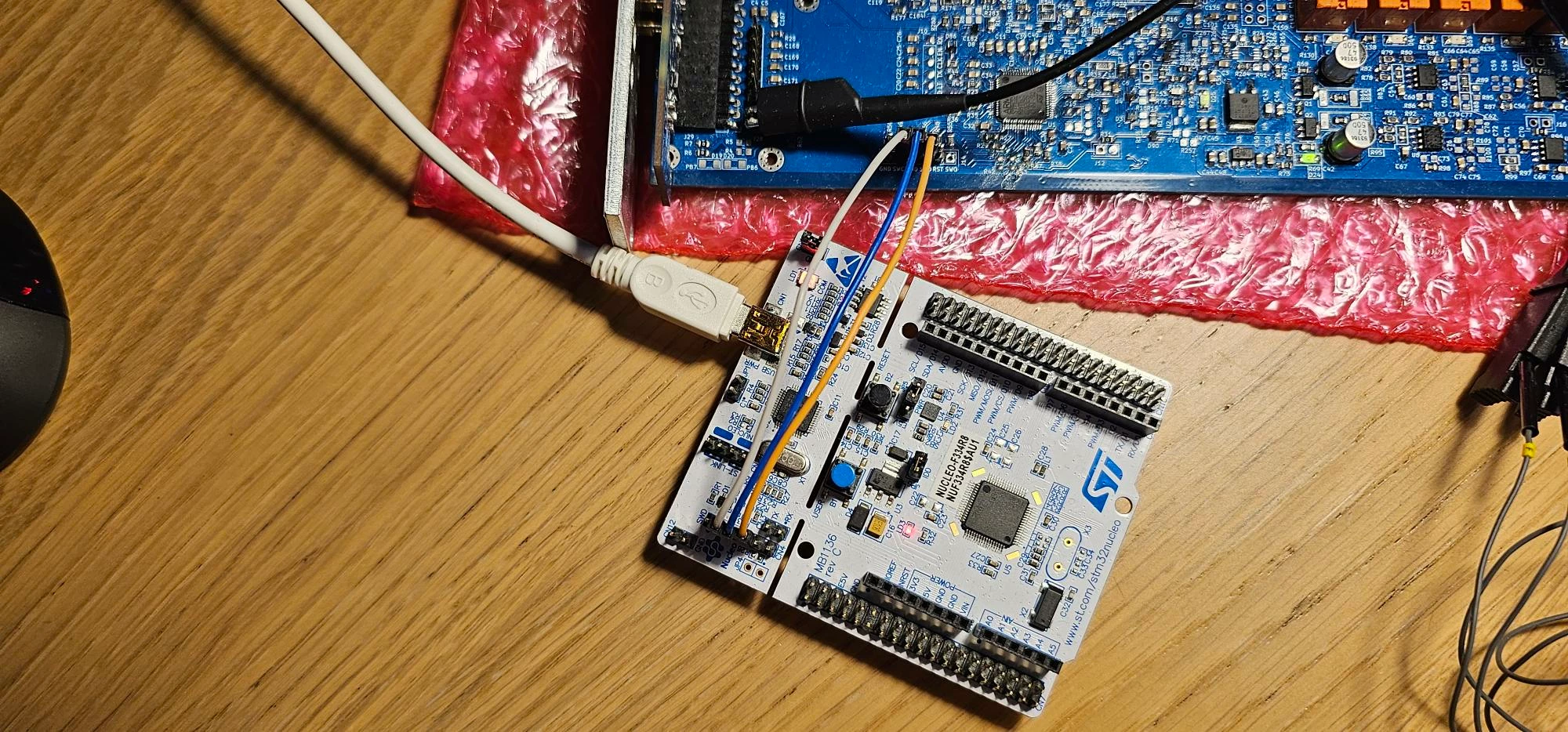

Can you show a pic of your construction (with st-link connected) ?

It doesnt look like debugger connection issue. This happens only if our racing condition occurs (both task and interrupt reconfiguring dma/uart). Other than that it can go for hundreds of hours without problem to stop the device. And when issue occurs i am able to connect to flash but not the RAM.
I have attached pic with board-debugger connections.
