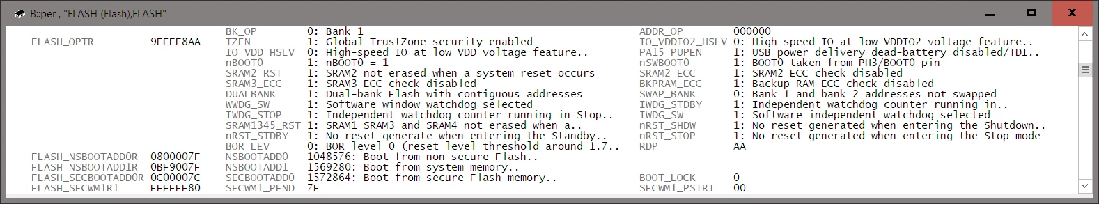

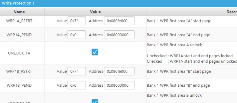

Pierre_Paris
September 20, 2023
Thank you for your ELF file @42Bastian Schick , I flashed it and get this error :
  • Can you please check your linker file ? That might be a memory zone definition overlap...
  • Also what are your OB configuration ? (RDP level? User config? and Write Protection with page size?)
Best Regards,
Pierre
42Bastian Schick
September 20, 2023
Yes there are memory regions with the same start address, but of size 0. So you can ignore the warning.
OB:
I hope above makes sense. CubeProgrammer does not allow to "dump" the OB info nicely :(
WRP2 same, only 0x081...
I attached a new ELF which I flashed w/o error/warning with CubeProgrammer.
Cheers

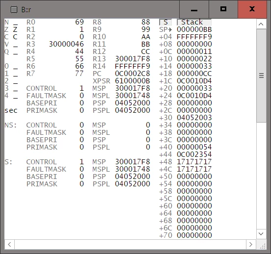

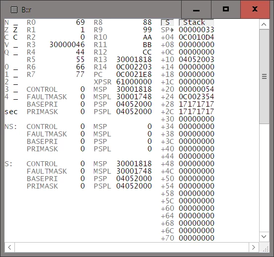

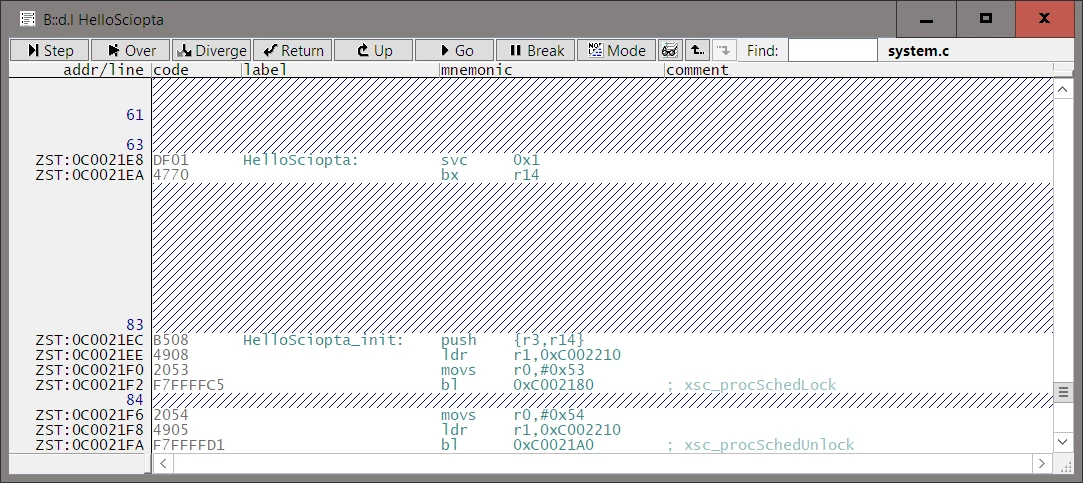

42Bastian Schick
September 28, 2023

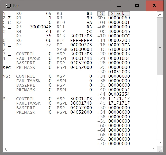

Ok, it is getting complicated. Here more pictures.
Anyway, at HelloSciopta you have this:
In my test, I set a breakpoint 0xC0021E8, registers/stack:
Single step "svc" instruction, new registers:
As you see, R13 is reduced by 0x20, r0-r3 ... stored to the stack.
Now restart to breakpoint. Change CONTROL to 1 (via Debugger) and singlestep:
Again, r13 is reduced by 0x20, but the stack contents was not modified.
Regarding security settings: These are identical for both use cases and I cannot find a single hint, that would explain why there is no content written.
BTW:
Only privileged software can write to the CONTROL register to change the privilege level for software execution in Thread mode. Unprivileged software can use the SVC instruction to make a Supervisor Call to transfer control to privileged software. Here is the PM of the STM32 Cortex -M33 in case
 This is not the issue here.
