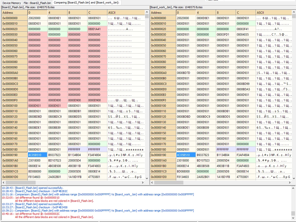

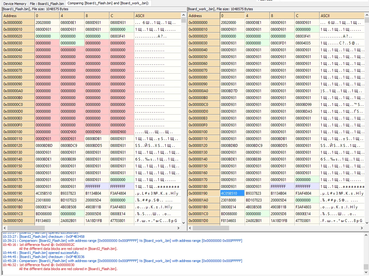

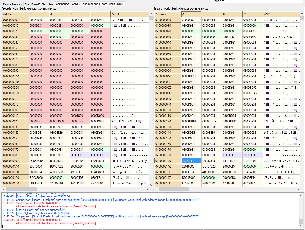

  1. Corrupted Flash memory in the initial part of the memory (addresses starting from 0x08000000 – see Figure 1). All corrupted bytes are located in the area of flash memory, called “Vector table”, that is responsible for the initial position of the addresses for interrupt. The first 16 bytes (0x08000000…0x0800000F) in Flash memory are ok, but all three boards has corrupted bytes in the range from 0x08000030…0x08000108.
  2. All corrupted bytes are located consequently (see Figures 2…4), and forms “corrupted range”, e.g., for the board 3 this range is 0x08000010…0x0800012B, for the board 2 this range is 0x0800002C…0x0800010A, and for the board 1 this range is 0x08000030…0x08000117. No any corrupted bytes in other flash memory addresses, except this corrupted range were found.
  3. In many cases, inside this corrupted range, all bits from one byte in Flash memory were set to 0x00 (so all bits are set to 0), but in some cases, only some bits are set to 0, such cases shown in Excel table with blue background. Some examples of such bytes are: correct data byte that should be is 0x3F – 00111111B, and corrupted byte is 0x1A – 00011010B, or correct data byte that should be is 0xD9 – 11011001B, and corrupted byte is 0xD8 – 11011000B.
  4. In all three cases, corrupted zone has “central” part, where all byte is corrupted (set to 0x00), but on the “border” zone (firsts corrupted bytes in memory), close to non-corrupted Flash memory, only some bits are corrupted (such cases shown in Excel table with blue background), or, corrupted and not corrupted bytes are alternate one after another (corrupted byte – non-corrupted byte – non-corrupted byte – non-corrupted byte – corrupted byte), shown in Excel table with green background. Taking into account, that some bytes in the correct Flash should be 0x00, it is not possible to investigate this alternation deeper, because such bytes, even in case of corruption, will not change the content.

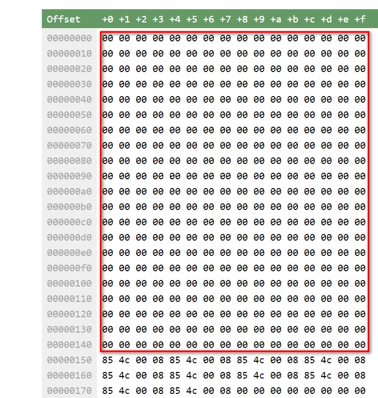

Ywang.3
May 30, 2024
We also experenced exactly the same issue. The starting part of the flash is set to be all 0, as shown below,
as the vector table is filled with 0, the mcu cannot be booted now.
