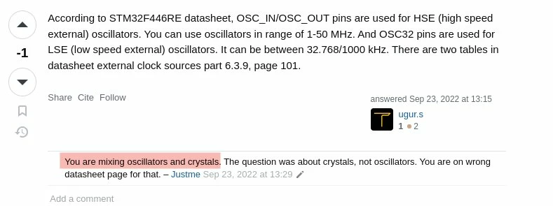

It is vital to use language and terms with great care and  precision in technical writing. Whenever you don't, you create confusion.
Newcomers often make the mistake of conflating the terms "crystal", and "oscillator". For example, see @Andrew_Neil   's multiple comments on this thread, where he does his utmost to banish this common error.
Quite recently, I made the same mistake when asking for help finding a low-power clock source.
We can forgive newcomers and ourselves our trespasses (I personally have, grudgingly), but shouldn't we expect more from official ST documentation?

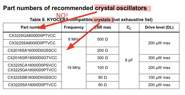

AN2867: Guidelines for oscillator design on STM8AF/AL/S and STM32 MCUs/MPUs
mixes and shifts between related terms multiple times in its 59 pages. The resulting confusion is enormous. Instead of working to remove confusion, ST's documentation contributes to it:
which is followed immediately by
Dear ST,  please flag this AN for review and urge the documentation team to be absolute tyrants about correct usage.

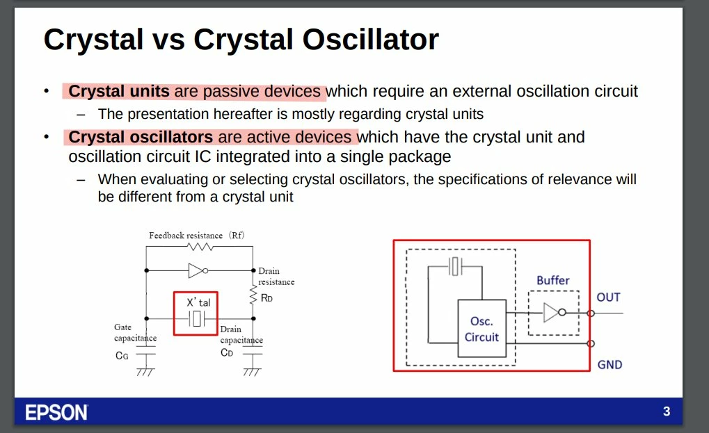

From [EPSON] Crystal Fundamentals & State of the Industry :
If ST writers lack a catch-all term, perhaps "Frequency Source" would do, instead of randomly selecting one of the three (crystal, oscillator, resonator) on each occasion. Including a glossary placed at the start of the appnote would enhance clarity as well.
