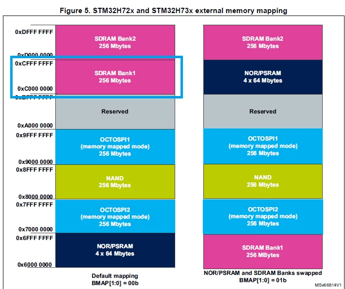

I am writing to report an apparent error in the STM32H72x/73x/74x/75x System Architecture Overview Application Note (AN4891) , specifically on page 28 , regarding the Flexible Memory Controller (FMC) section.
The document states:
"For STM32H72x/73x, only SDRAM bank 1 can be remapped from 0xD000 0000 to 0x6000 0000 ."
However, based on the STM32H7 reference manual and other technical documentation, the default address for SDRAM Bank 1 is 0xC000 0000 , not 0xD000 0000 . Therefore, the correct remapping should be:
"For STM32H72x/73x, only SDRAM bank 1 can be remapped from 0xC000 0000 to 0x6000 0000 ."
This discrepancy could lead to confusion for developers working with the FMC and SDRAM memory mapping. I kindly request that this error be reviewed and corrected in the application note to ensure accuracy and avoid potential issues during development.

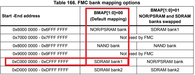

Indeed SDRAM Bank1 on STM32H72x/H73x is mapped by default at 0xC000 0000
From RM0468:
Moreover, in the same application note AN4891, figure 5, SDRAM BANK 1 default address is mapped at 0xC000 0000:
So it's a typo. Thank you for raising it.
