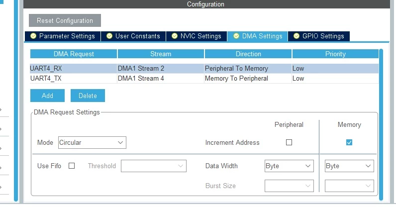

Hello. I have packet each 200ms (8 byte) and i have sometimes from computer register set function, again 8 bytes.
And time to time getting USART ovverrun error. That is not a big deal, but i just don't want to miss correct register write to MCU event.
How do i handle this so never get overrun ? System needs to be 100% reliable, i was thinking about timeouts, but it looks to be too dificult to implement.
Any idea how to play this ? ( Rx is on interrupt, while Tx is on Timer 5Hz)

never get an overrun by using DMA Rx like this:
Super simple to use Rx in a circular DMA buffer,
Basically, initialise the RxPtrOut to zero.
RxPrtOut =0;
the RxPtrIn is a hardware register the DMA buffer pointer, which is pointing to the next byte destination in the DMA buffer
so Read the DMA pointerIn and compare it to your pointerOut, that will tell you how many bytes are unread.
I set the circular buffer size to 256bytes,

Yes, already impelmented based on LL example example and yes, never overrun interrupt was triggered. Just now i have to somehow synchronize my header and data so i could read registers. Simple 8byte array and some folding algorithm is needed.

Ok, so after few hours of coding have working code.
Idea is if NDTR is showing that at least single bite is transferred and it is not header, i will reinitialize DMA and that's it.
This check happens at 5Hz. mainly i need to avoid any false UART at turn up or any other event. Master that sends data should send it by 8 words, so after DMA reset, it will never trigger unless i inject any data to uart, that not suppose to be. (tested with million packets)
And DMA is transferring single frame size and generating TC interrupt in circle mode.

This night get my code testing. Around 2 milion bidirectional packets was send, get no errors, not a single DMA reconfiguration was triggered, but that is in good conditions wituout any power ups. So it looks like very simple and effitient code :)
