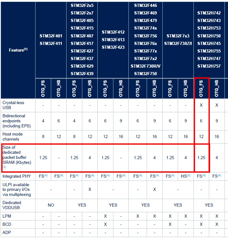

Correct OTG_FS FIFO size for STM32H753
We are currently using STM32H753 and are setting up USB Fifos. There is some contradictory information about the available sizes.
AN4879 mentions that the available SRAM size is 1.25kBytes for OTG_FS:
2026-03-18 13_54_15-an4879-introduction-to-usb-hardware-and-pcb-guidelines-using-stm32-mcus-stmicroe.png

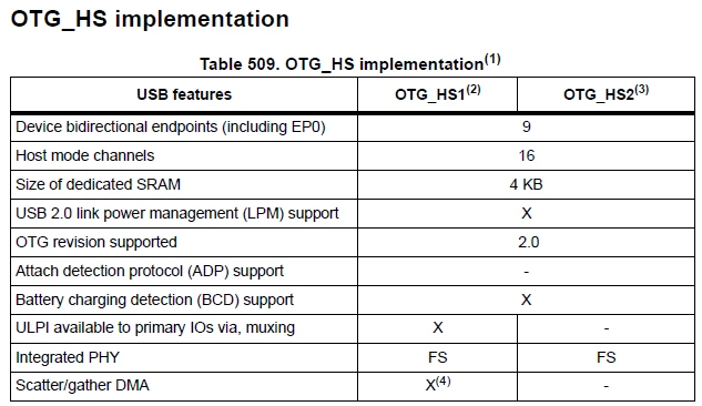

In the reference manual RM0433 I can only find 4kB for both OTG_HS peripherials, where OTG_HS1 is used for OTG_FS:
2026-03-18 13_56_38-rm0433-stm32h742-stm32h743753-and-stm32h750-value-line-advanced-armbased-32bit-m.png
What information is correct?

Hello @DZimm.9
Sorry for not coming back to you sooner
the OTG_FS FIFO size mentioned in the reference manual is the correct one and AN4879 will be corrected in the future
