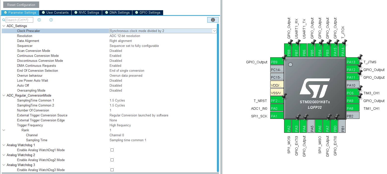

Hello, I need help with ADC and DMA settings. My application is VERY EASY but I do not understand the setup parameters. The application is that I just start CPU and the ADC raw value should independently transfer via DMA to variable. When I need the value (randomly) I just read the internal variable. I saw several youtube manuals but I still have 0 on output even when there is 1V. I use PA0 pin (ADC1, chan 0) on very easy CPU STM32G031. I need to use DMA Channel 4 (Channel 1 and 2 are used for USART_RX and TX)
My setup:
The generated code is like this (I use LL):

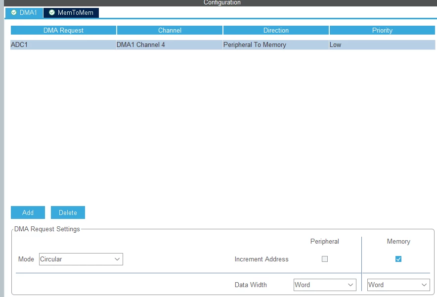

 /* ADC1 DMA Init */
 /* ADC1 Init */
 LL_DMA_SetPeriphRequest(DMA1, LL_DMA_CHANNEL_4, LL_DMAMUX_REQ_ADC1);
 LL_DMA_SetDataTransferDirection(DMA1, LL_DMA_CHANNEL_4, LL_DMA_DIRECTION_PERIPH_TO_MEMORY);
 LL_DMA_SetChannelPriorityLevel(DMA1, LL_DMA_CHANNEL_4, LL_DMA_PRIORITY_LOW);
 LL_DMA_SetMode(DMA1, LL_DMA_CHANNEL_4, LL_DMA_MODE_CIRCULAR);
 LL_DMA_SetPeriphIncMode(DMA1, LL_DMA_CHANNEL_4, LL_DMA_PERIPH_NOINCREMENT);
 LL_DMA_SetMemoryIncMode(DMA1, LL_DMA_CHANNEL_4, LL_DMA_MEMORY_INCREMENT);
 LL_DMA_SetPeriphSize(DMA1, LL_DMA_CHANNEL_4, LL_DMA_PDATAALIGN_WORD);
 LL_DMA_SetMemorySize(DMA1, LL_DMA_CHANNEL_4, LL_DMA_MDATAALIGN_WORD);

But how can I setup the variable where is the ADC result saved?
How can I start the ADC?
I tried to use ADC1->CR |= ADC_CR_ADSTART; and  reading ADC1->DR; but only zeroes...
Thank you

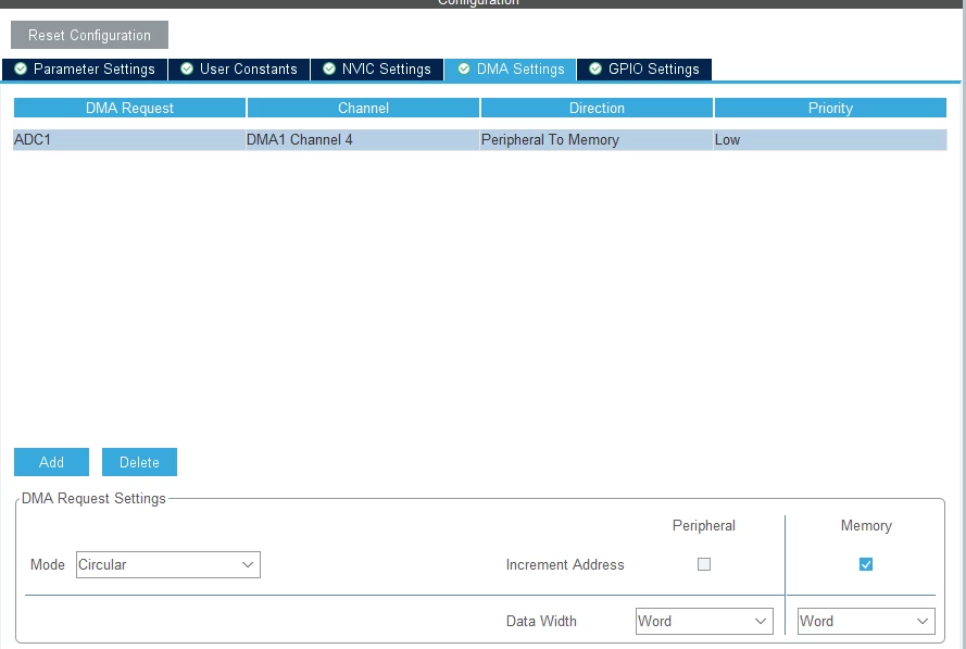

I tried to use HAL library. I exported this settings:
And added
uint16_t ADCACTValue;
 HAL_ADC_Start_DMA (&hadc1, (uint32_t *)ADCACTValue, 1);
but the result is still 0.
If I use for testing this in main while cycle, result is correct:
 HAL_ADC_Start(&hadc1);
 HAL_ADC_PollForConversion(&hadc1, HAL_MAX_DELAY);
 ADCACTValue = (uint16_t)HAL_ADC_GetValue(&hadc1);
What is wrong in my settings? Or do I need to add more code tu run this?
Thank you

Thank you, you are right, but I tested all. If I use (uint32_t*)&ADCACTValue then program code stuck.
I exported the code from CubeMX and when I use HAL_ADC_Start_DMA, nothing happens.
I tested again on NUCLEO kit with HAL and same problem. I am not able to use STM32G031K8 with ADC on DMA. I must say that I spent many hours on this and no result. I really do not know where is the problem - on STM32F103 it worked, but not on STM32G031.

1. set pointer :  (uint32_t*)&ADCACTValue
2. DMA with transfer 1 sample is totally nonsense, as "circular" = in two blocks, how should this work with 1 sample ???  -> so make an array and transfer 100 samples or whatever, maybe circular with callbacks:
uint16_t sampels[120];
HAL_ADC_Start_DMA(&hadc1, (uint32_t *) &sampels, 100);
- Dont set circular - for only 1 transfer.
-- or dont use DMA , if you really want only one sample.
3. set half-word access:
4. Use HAL , not LL . (Anyway same speed : if DMA used, this is the speed of the DMA then. HAL or LL or bare metal will change just the setup/call time , maybe 1 x 1 us more, when using HAL. This is nothing to think about..)

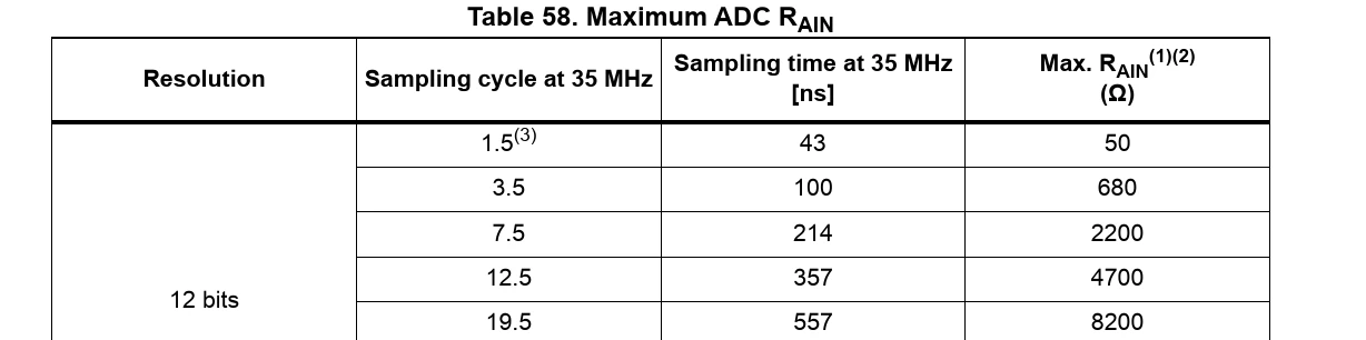

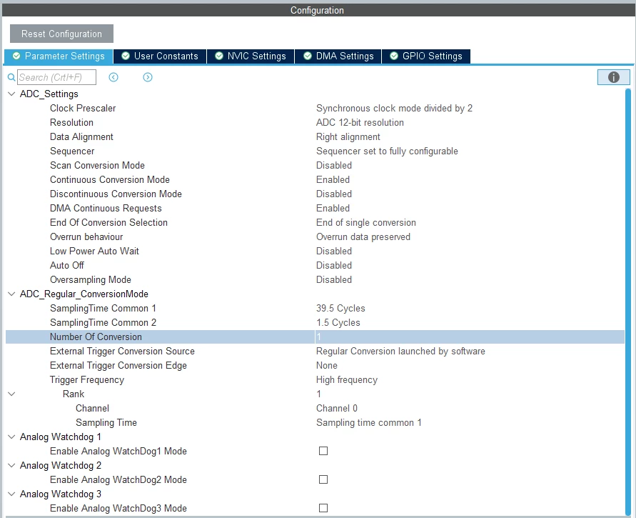

Output impedance of my source is around 1 kiloohm, so not very small. Am I correct that in this case I need to setup as sampling time as possible?
Is necessary to have 160 Cycles?
Sampling time about 160 Cycles means on 64 MHz conversion time around (1/64meg * 160) = 2,5 us?
AScha.3
August 5, 2024
The cycles here are on adc-clock , not cpu-clock. So if adc at 32M -> 5us .
from ds:
need about 200ns for < 2kohm input , so at 32M adc clock 7.5 sam.cyc. setting should be ok;
Tconv then 20 cyc /32M -> 0.6 us .
How fast is your input signal ? (Because if not fast, like a pot , adding a 100nF cap at the input gives low impedance, to use short sampling time.)
Stastny.Petr

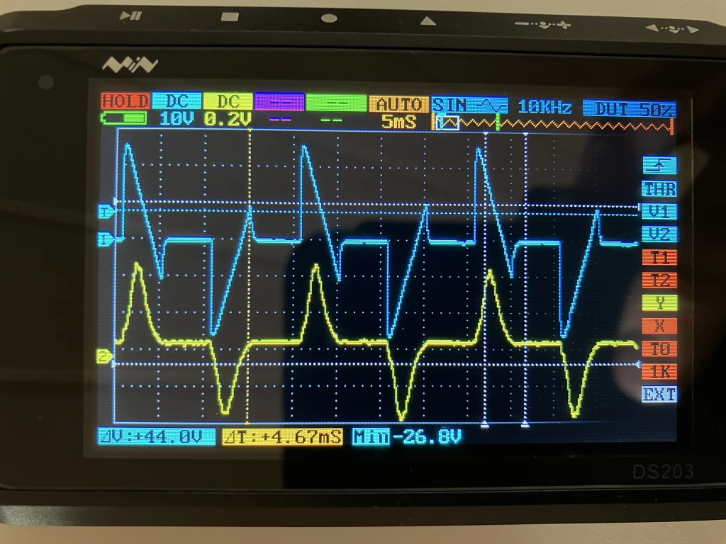

My signal is current feedback from the triac controlled motor. When I switch on the triac, I start to find maximum/minimum (it is offseted to 3.3V/2) current peak to check overtorque.
So it is 100Hz half-period and ever half period I need to find maximum/minimum value.
1kOhm output impedance with + 100nF on the input is maybe acceptable (?)
AScha.3
August 5, 2024
No, 100n too much here. But some cap you should have here, because you might get spikes from switching.
Maybe 2...10nF could be fine. And some protection of the adc input ... in case a big pulse coming... .
Just check with scope, adc input not yet connected, that signal is as expected and in range for adc.
