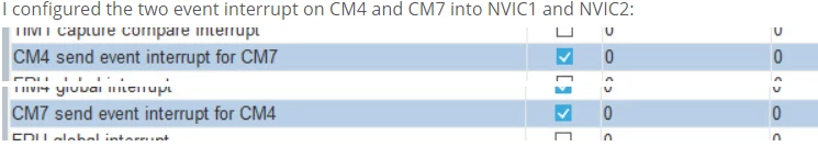

I am working on Nucleo-h745ziq board. I enable cm4 to cm7 event and cm7 to cm4 .I enable the timer in cm4 and cm7 .But the event it doenot occur in cortex m7 ,my programme is below please help me.

The event doesnot create in cortex m7.Led doesnot blink in this CM7_SEV_IRQHandler(void).In each 2 second event gets called in both core.
How are you verifying this? There is no delay between the two toggles, so if you're just looking at the LED, it's unlikely you'll be able to detect it lighting up for a microsecond.

If I placed delay then programmed doesn't work properly.
  1. void CM7_SEV_IRQHandler(void)
  2. {
  3. /* USER CODE BEGIN CM7_SEV_IRQn 0 */
  4. HAL_GPIO_TogglePin(GPIOB, GPIO_PIN_14);
  5. /* USER CODE END CM7_SEV_IRQn 0 */
  6. /* USER CODE BEGIN CM7_SEV_IRQn 1 */
  7. /* USER CODE END CM7_SEV_IRQn 1 */
The Led does not blink .
October 19, 2021
On the other hand, if you placed a delay in the ISR handler, and it had an effect, the cpu is most likely getting there. Perhaps your pins are not initialized.
