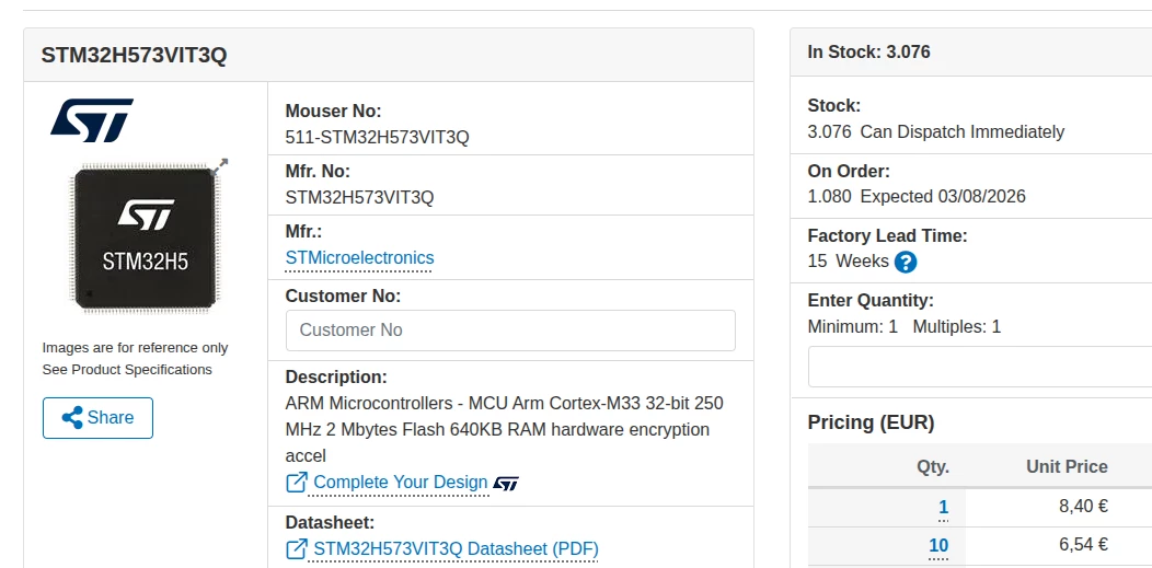

availability :
Jul 4, 2026 6:28 PM UTC
Re:
> A: If you don't want to use the SMPS then select the non-SMPS package that has LDO enabled. Which means a redesign.
Not just redesign, but 20x more board space. No other package variant comes close to the WLCSP in footprint size. And WLCSP is only available in SMPS. (For me, if I had that much board space, my solution would be completely different - I would change all of the chips, including the microcontroller, and a much cheaper microcontroller would work.)
Re: availability: right, if you don’t need WLCSP, then availability is not an issue. The problem for OP (and me) is that we DO need the WLCSP, but it’s not available.
AScha.3
Jul 4, 2026 7:41 PM UTC
Ok, i see - STM32H573MIY3Q - no stock now.
