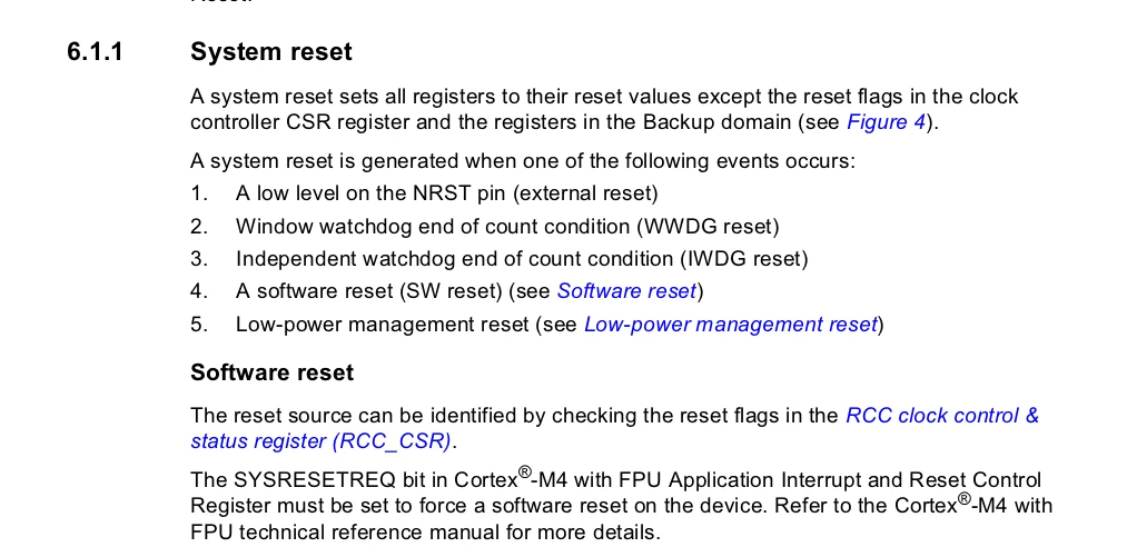

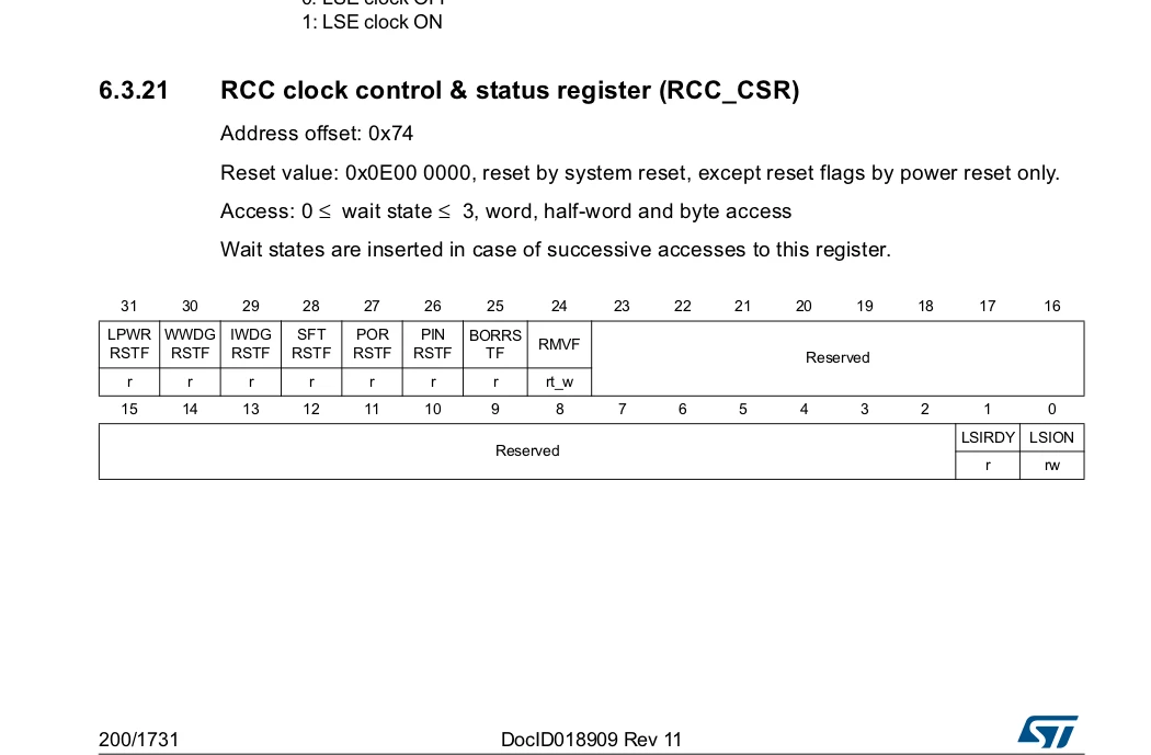

I think you need to reproduce the behavior at your desk / lab.
Then, check the RCC CSR register. Here a snapshot from the F40x manual :
And here a list of reset causes, from the same manual:

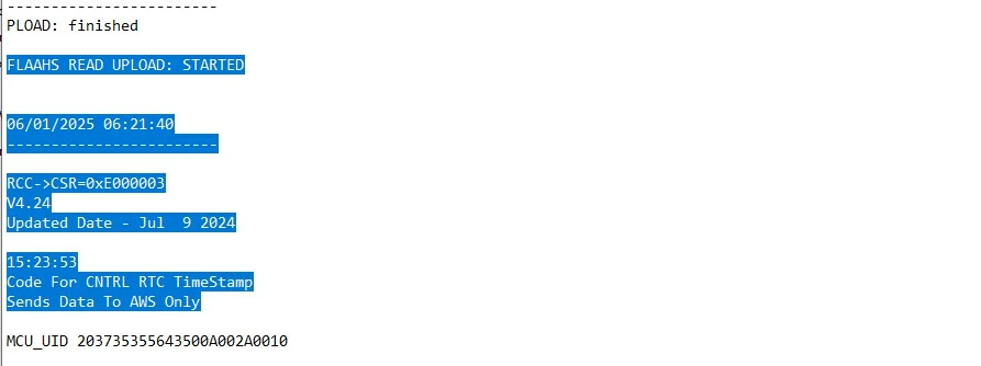

Thanks for responding fast on the query, I have checked the MSP, HFSR, BFAR, CFSR
1. Yes I have enabled the WDT in the system for 8 seconds and that is also getting refreshed in the systick interrupt. So firmware sometimes works for 5 minutes then restarts or in sometimes it just restarts after 20-30 minutes initializing the program in some devices. Some of the device are working perfectly fine on site but some are not sending data at all. After site visit we have found out that the controller is never able to perform the data polling cycle, it is getting restarted before that.
2. I have checked the power lines of controller form oscilloscope but found no drop/rise  in the power so that controller may get restart or damaged.
3. This are the values of RCC->CSR=0x0E000003, 0x3E000003, 0X2E000003 I am getting.
4. I have disabled the cache for find out the correct value of PC, but the values are always random.

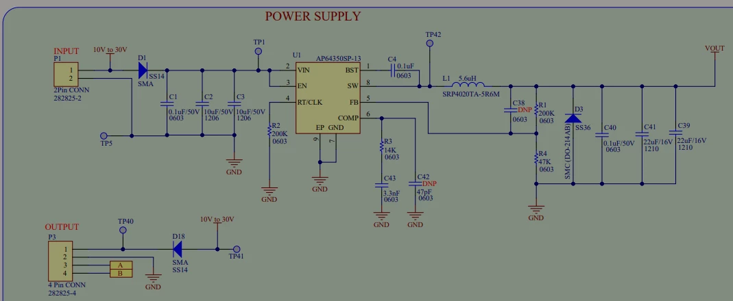

Please find the power supply design.

power circuit designpower circuit design
