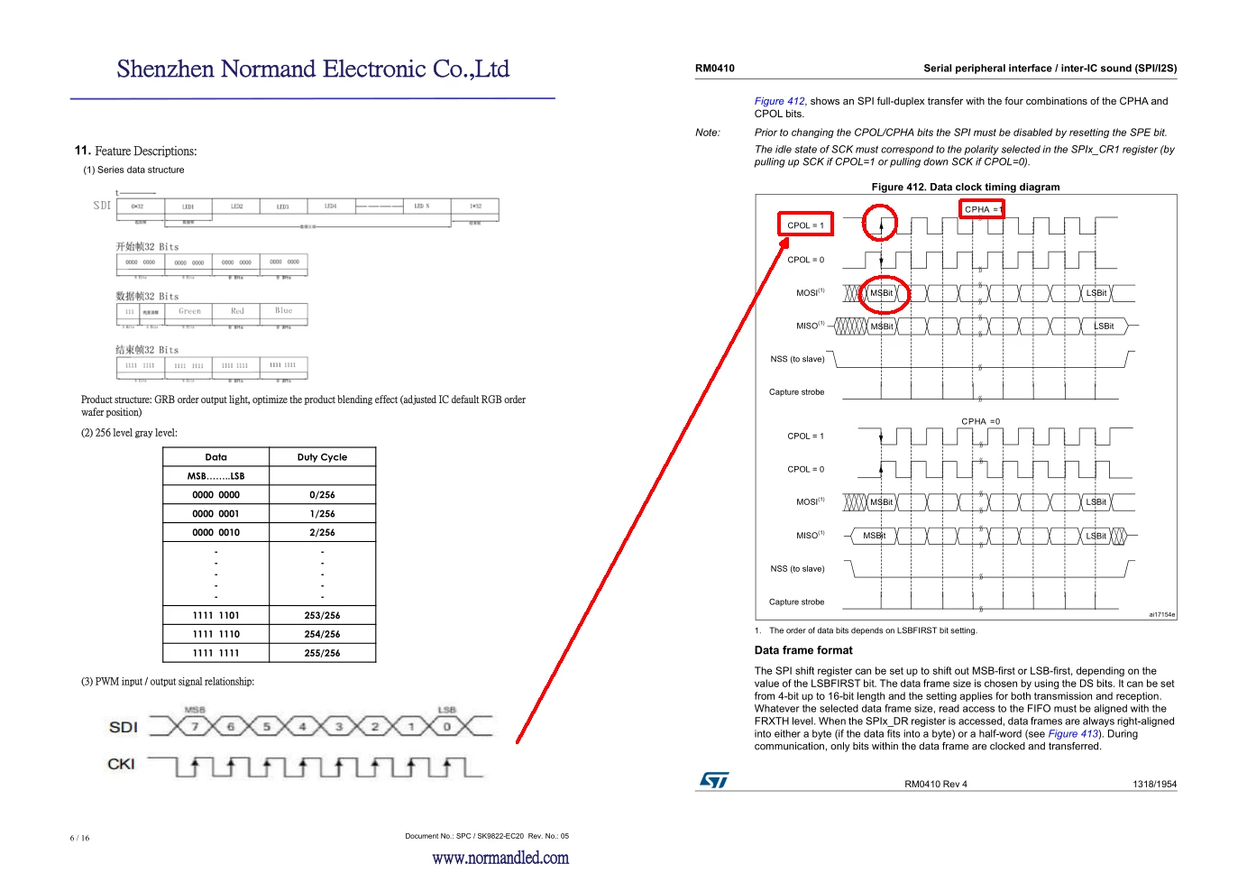

Hi
I need to control some SK9822 2020 RGB LED's.
I figured out that with the information on this website I can control them over SPI in transmitt only mode.
The Problem I have now is, that I need to do it using Registers and can't use CubeMX for setting up SPI.
I have seen several tutorials like this one explaining how to set up SPI using Registers, but wanted to ask here for a specific solution for these SK9822 LED's.
I hope someone knows the SK9822 LED's / have done somthing similar or at least can explain how I'd set up SPI in Transmitt only mode.
HW used
STM32F777
  • SPI1 @30MHz
SK9822 2020 LED's
Thanks for the answers in advance!

This
and the maximum frequency (baudrate) are the only specifics to be set up in the STM32 SPI.

Hi
Thanks for the answer!
What's with the other parameters of SPI?
How do I send the correct data?
