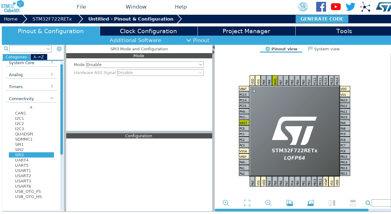

It's possible to control 5 SPI devices with the STM32F722RET6? LQFP-64

Do they actually need unique interfaces?
Some SPI can use a GPIO as CS (Chip Select), and disconnect MISO when inactive.
You might also be able to use a 3-to-8 decoder to save pins wrt CS for multiple devices.
You could walk the datasheet and see if you can instantiate 5 separate SPI, or use CubeMX.

In one I can use UART.
But in the others I need to use SPI.
I have two SPI sensor mems and one dual/quad SPI and QPI flash memory and one SPI OSD.
Can I use any pin for the SS/CS selector chip?
Tesla DeLorean
Guru
November 11, 2019
QSPI has fixed/committed pins for NCS, common CLK between Bank1/Bank2
64-pin is quite limiting

Good morning,
Thanks for the replies,
So I'm going to use so:
SPI1 for the two sensor mems and two gpio for the CS#
SPI2 for the SPI flash memory
SPI3 for the OSD
