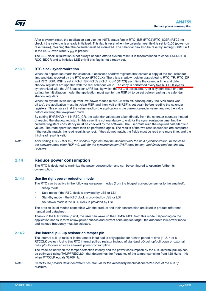

There is an inconsistency in RTC shadow register update frequency description. Some places in text mentions that shadow register update happens once every RTCCLK period:
34.3.5, 36.3.4: "Every RTCCLK periods, the current calendar value is copied into the shadow registers..."
34.3.10, 36.3.8: "The copy is performed every RTCCLK cycle."
And other place say that it actually happens every other RTCCLK cycle:
34.6.7, 36.6.3: "Calendar values (when reading from RTC_SSR, RTC_TR, and RTC_DR) are taken from the shadow registers, which are updated once every two RTCCLK cycles."
I assume that "every two RTCCLK cycles" is correct, because some other Reference Manuals state this consistently.

The shadow registers are updated every ck_rtc cycle on RTC2_v2_0 and all versions after that.
I think it was "every two cycles" for v1.
So, "every two RTCCLK cycles" is wrong and should be “every RTCCLK cycle�?.
Hope this answer your question.
This means to fix virtually every STM32 RM, except RM0008, isn't it?
And also AN4759
Also, AN4759 should mention in this very chapter the RTC v2 lock bug.
Jan

Hi @Imen.D ,
AN4759 has seen rev.8 at 08-Nov-2022, yet the line in question hasn't been corrected.
