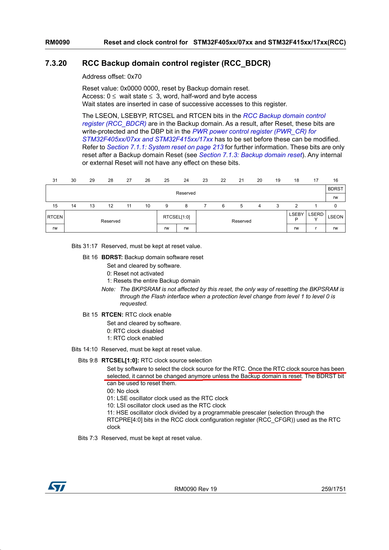

I have spent a lot of time doing the backup domain reset at power-up.
Some context is here
https://www.eevblog.com/forum/microcontrollers/will-stm32f4-start-if-vbat-is-lo-or-floating-due-to-dischargedunfitted-cell/
It turns out that the ultra convoluted ST code does a reset, in HAL_RCCEx_PeriphCLKConfig() but it does it only when certain bits in BDCR are unchanged. Does anyone know why?

		/* Reset the Backup domain only if the RTC Clock source selection is modified from reset value */
		tmpreg1 = (RCC->BDCR & RCC_BDCR_RTCSEL);
		if((tmpreg1 != 0x00000000U) && ((tmpreg1) != (PeriphClkInit->RTCClockSelection & RCC_BDCR_RTCSEL)))

waclawek.jan
Jun 28, 2023 8:57 AM UTC
The comment says it: it resets the backup domain only if it is not in reset state and you want to change the RTC clock source. The reason has nothing to do with the VBAT-domain brownout-induced corruption/erratum, it's relatively new after all ; Cube/HAL does it because of:
To discuss your particular setup further please start a new thread, perhaps linking to this one (and the eevblog one) as appropriate.

It looks like we have the same issue here with an STM32F412CG.
Both VDD and VBAT are powered together by a switching regulator that will retain the power supply through some GoldCaps when the input voltage to the device is powered off. But after the switching regulator turns off because the GoldCaps are empty, it will still provide some hundred mV to VDD and VBAT.
We observe, on 2 of 20 devices that are tested, that registers contain strange values. The LSEON (external low frequency oscillator enable) bit in RCC_CSR was sometimes set, causing the peripheral clock initialization to fail and our device to "freeze" because init waits until the LSE is stable, but this does not happen because we do not have an external low frequency oscillator equipped.
After I removed the peripheral clock initialization, we also observed that PC13 pin lost its function as an input sometimes. I assume here the pin has been configured for some RTC related special function like mentioned in the reference manual.
I now added a routine to reset the backup domain directly after SystemClock_Config() - can someone please tell me if this is correct?
void ResetBackupDomain()
 /* on displayUnitA, we observed issues with randomly set bits in backup domain registers.
 * See http://www.efton.sk/STM32/gotcha/g133.html for a description
 uint32_t tmpreg;
 /* Enable write access to Backup domain */
 PWR->CR |= PWR_CR_DBP;
 /* read back for a delay - see errata, "possible delay in backup domain protection" */
 tmpreg = PWR->CR;
 __HAL_RCC_BACKUPRESET_FORCE();
 __HAL_RCC_BACKUPRESET_RELEASE();
 tmpreg &= ~PWR_CR_DBP;
 PWR->CR = tmpreg;
This issue isn't mentioned in the errata sheet, but only in errata for STM32G071x8/xB (section 2.2.11 of https://www.st.com/resource/en/errata_sheet/es0418-stm32g071x8xb-device-errata-stmicroelectronics.pdf)
I think ST should add it to the errata of the affected devices.
best regards,
Frank
waclawek.jan
Jul 23, 2024 3:47 PM UTC
It looks OK, provided that PWR's clock in RCC has been set previously (and doing that while observing the needed delay between enabling clock and accessing peripheral... :) )
