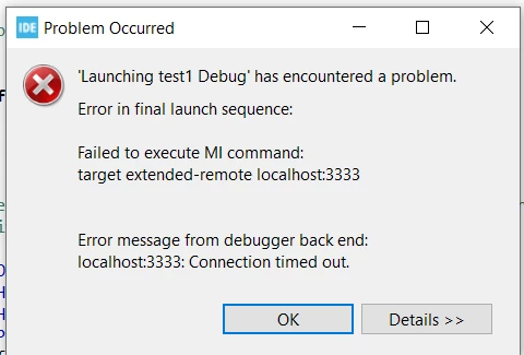

while i was trying to run a program on STM 32 F103C using ST link V2 on STM32cube 1.13.2 ide, getting an error "read version failed".
following is the error message.
Unable to solve this error.

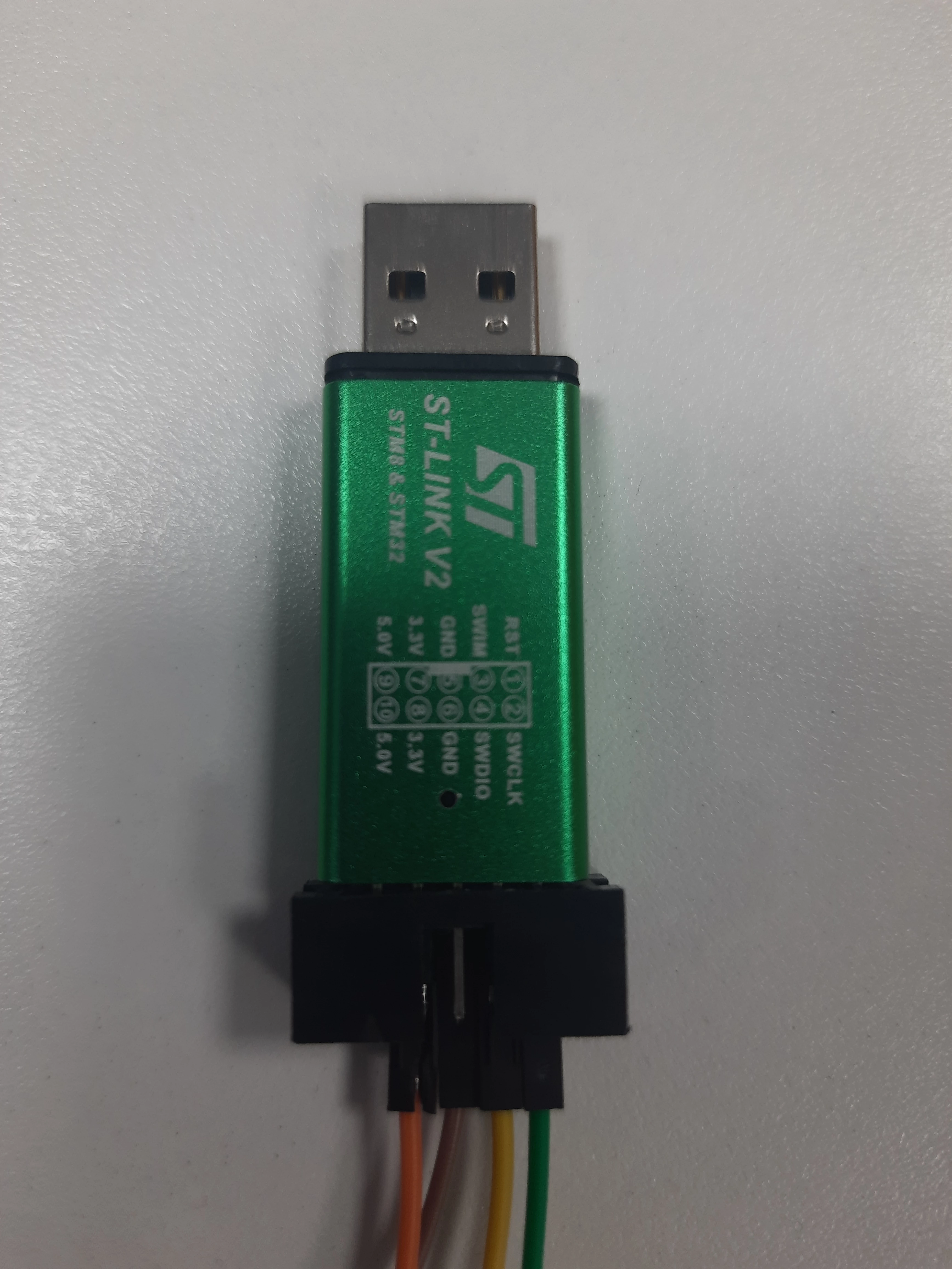

Please upload a photo of your ST-LINK.

Well that's definitely a third-party product and not an authentic ST-LINK

You might have counterfeit pods or chips. ST provides no support for those devices.
Check if the ST-LINK/V2 is viable directly under STM32 Cube Programmer. If it is then you need to check the settings of how the GDB Server is brought up and local/remote settings there.

@Pal_555 You have saved money in the wrong place and should buy an original ST-LINK (if you buy cheap, you buy twice).
However, there are even ways to save money: if you buy a cheap NUCLEO-64, you can use the ST-LINK that is also included. Either break it off or disconnect the respective target MCU by removing the ST-LINK jumper. A NUCLEO-144 can also be used, but it is more expensive than a NUCLEO-64.
