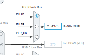

The DMA and sampling is working fine, but i am not sure how to set up the clockrate of the ADC properly.

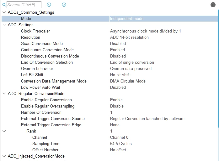

The ADC is currently running in Asynchronous mode with divider 1 and the sampling time is set to 64,5 Cycles.
The clock rate of the ADC is currently set to 2.34375 MHz in the Clock Configuration.
Currently i store 16 samples in my DMA buffer:
HAL_ADC_Start_DMA(&hadc1, (uint32_t*) ADC_DMA_buffer, 16);

When I increase the clock frequency of the AD converter, to lets say 50 Mhz, the sample rate does not change
and I don't know why. The LED has still the same frequency of 17,36 kHz. Is there something I am missing?
In my imagination I thought the clock frequency should directly relate to the sampling rate of the ADC.

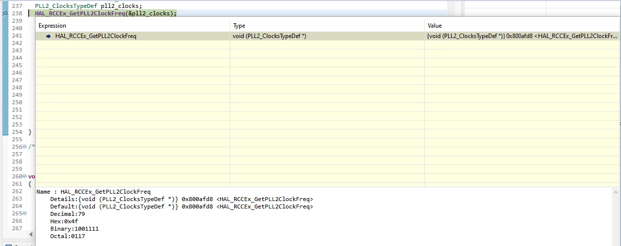

Probably the ADC clock is not actually changed then. Are you regenerating the code?
Call HAL_RCCEx_GetPLL2ClockFreq and verify it returns the expected value.

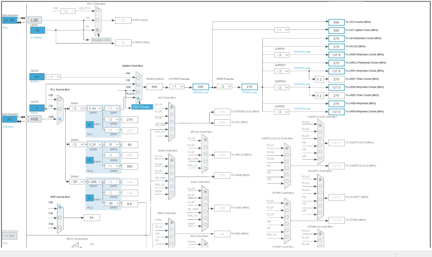

Looks like your ADC clock is 40 MHz based on your LED frequency, maybe 80 MHz. Does that ring a bell?
17.36kHz*2*(64.5+7.5)*16 = 39997440 Hz
138kHz*2*(1.5+7.5)*16 = 39744000 Hz
Could be I'm missing something else but not sure what it would be.

For the HAL_RCCEx_GetPLL2ClockFreq function you mean like this, right?

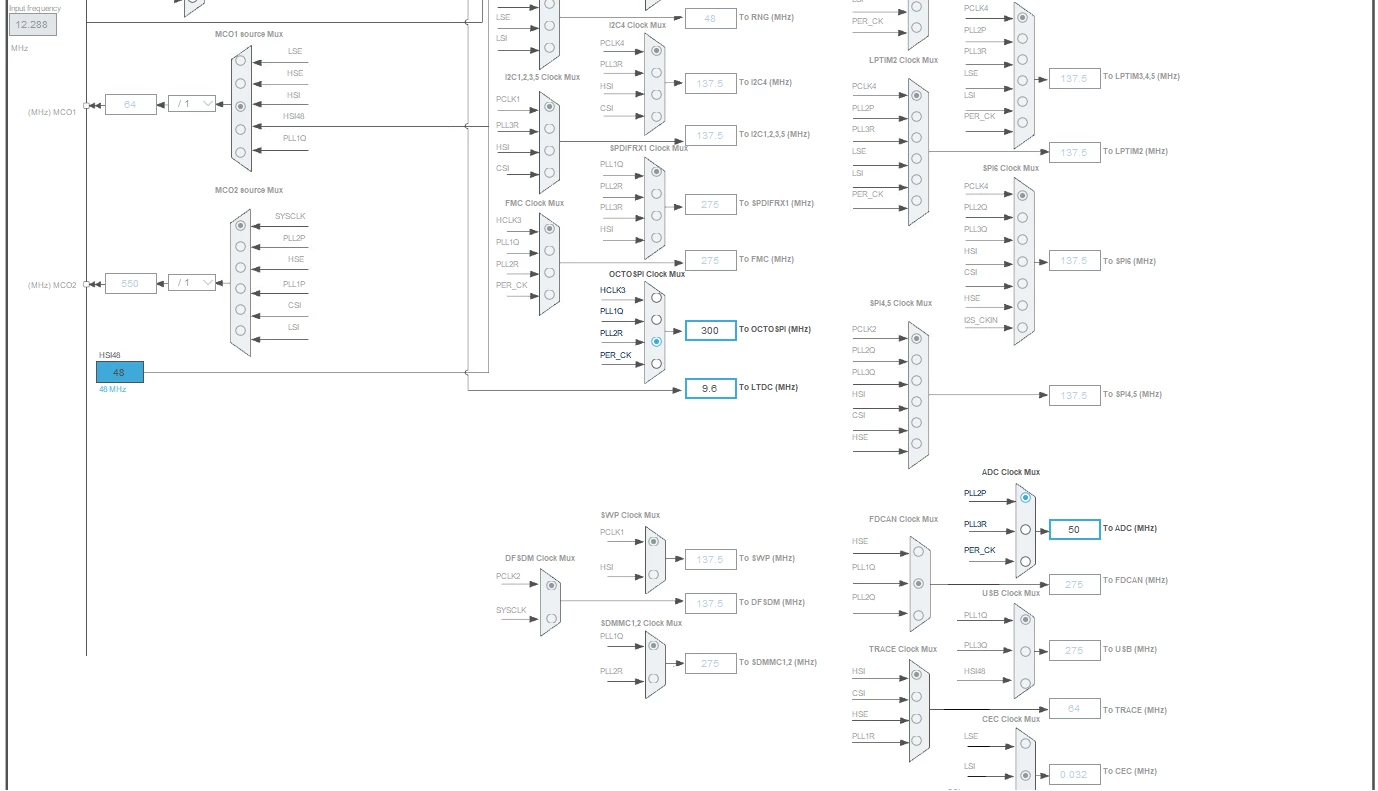

Here is an overview of my clock settings, it don't really know what causes the wrong ADC clock frequency...
@raptorhal2The ADC is only triggered once in software, then it is running in "Continous Conversion Mode" with active "DMA Circular Mode". What is limiting the sample rate with this setup?

Yes, and do the values in pll2_clocks match what you expect?
If they do, not really sure what it could be.
