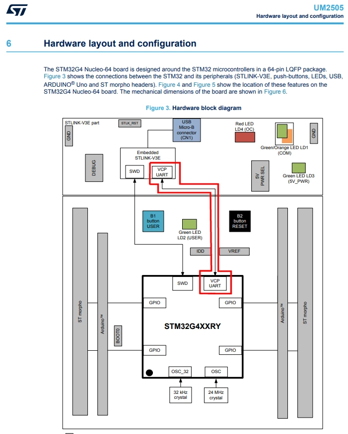

I'm just getting started with the STM32, only got the NUCLEO-G474RE board yesterday.
I need to communicate from a PC to the STM32 over USB.  Am I correct in assuming that the CN1 USB connector is only available for ST-LINK, and I need to attach a second USB connector with breakout pins onto the Morpho connector?
Is there a brief description somewhere of which USB lines go to which Morpho pins?
Thanks!

Right, you need to add a board with a USB connector. See the manual for your Nucleo board and the STM32G474 datasheet for Nucleo pin connections and G474 pin functions respectively.
What kind of communication do you need?
The ST-Link on the board also provides a Virtual COM Port (VCP);  that allows you to communicate from a PC to the STM32's UART over USB - see Fig 3 in the User Manual:
See also section 6.6.5

Thanks for the pointers!  But I can't figure out how to tell the STLink to enable its VCP.  Is there a document that shows me how to configure the IOC file in STM32CubeIDE?

If you've started a new "board" project then the VCP is already enabled. If you want interrupt, you have to enable the NVIC.
