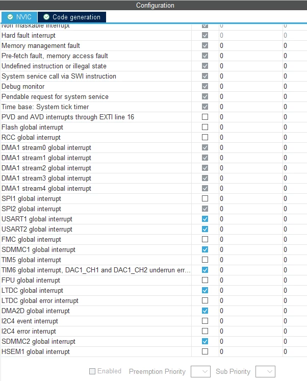

Connecting eMMC to SDMMC1 on the STM32H7
Hi.

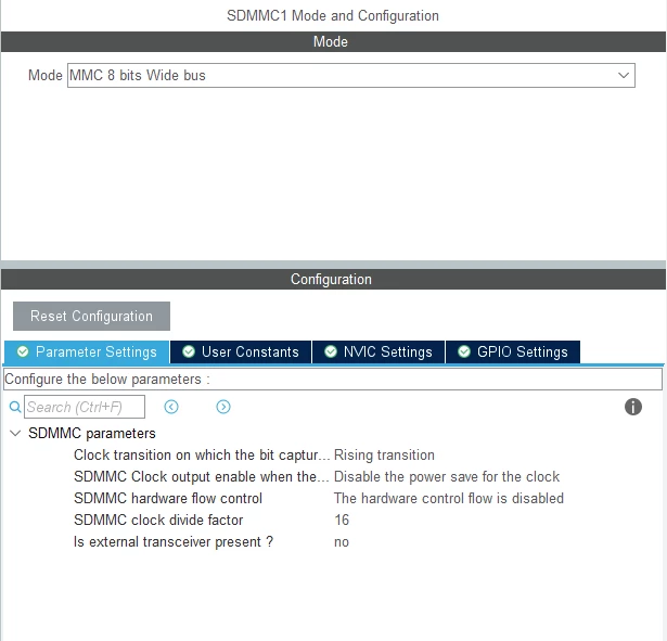

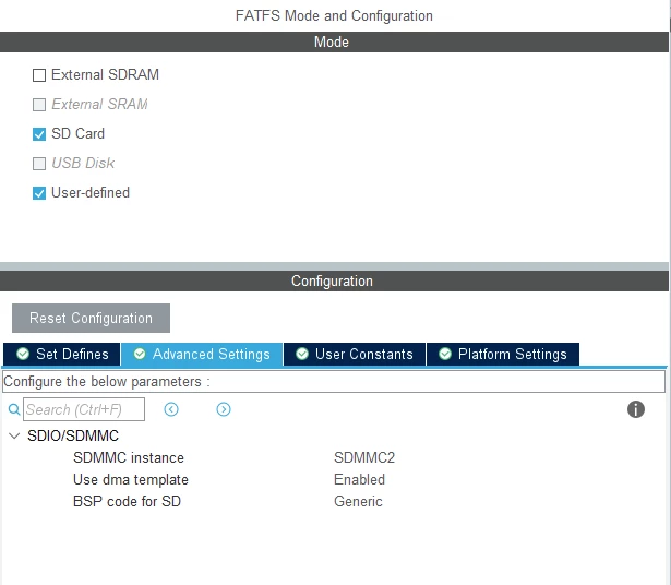

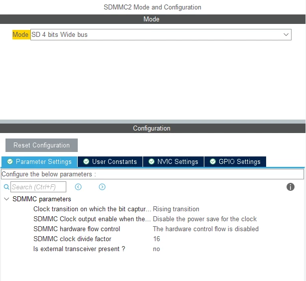

I am using SDMMC1-eMMC(16GB), SDMMC2-SD Card connected on a custom board.
Both eMMCs and SD-Cards use FatFS as their file system.
Both work fine when used alone.
However, if you use f_open or f_write on FatFS on eMMC, you sometimes get an error and the FatFS becomes unusable afterward.
My settings are as follows.

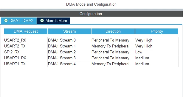

I tried to find the cause by disabling all device drivers and features and then enabling them one by one.
The problem I found was that FatFS on eMMC often caused problems if the ability to receive UART data via DMA was enabled.

The following code implements a disk file for eMMC. Note that we have not used DMA.
I'm guessing it's a cache issue with memory between SDMMC1 and the UART, but I don't know the exact cause.
Can you tell me what I need to fix?

There should be examples under H7 FatFs of "CACHE MAINTANCE" being used to ensure cache coherency when using DMA, and assort DCache Clean / Invalidate by Address functionality.
You will still need to make sure that RAM buffers are 32-byte aligned, and perhaps implement methods so Polled or DMA methods can be used when that's not the case. ie use single sector polled methods.
Generally you can avoid this by having large aligned buffers you use for f_read / f_write, and you don't do small / spanning operations.
https://github.com/STMicroelectronics/STM32CubeH7/blob/master/Middlewares/Third_Party/FatFs/src/drivers/sd_diskio_dma_template_bspv1.c
In polled mode the address in RAM should matter far less, but bandwidth becomes a significant issues as speed of transfers increase.
Not sure why the USART's would have an issue, but you can't expect to ignore a SD/MMC mid-transfer, there's a FIFO but it's not going to let you wander off, switch tasks, or do interrupts/callbacks for very long.
