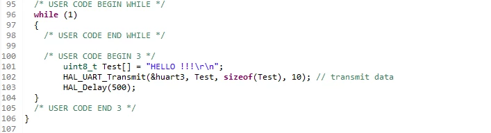

this pin configuration and code for g071

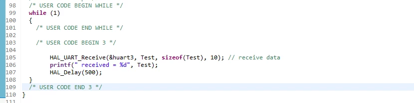

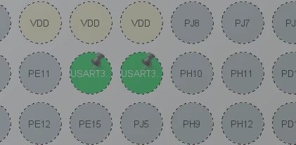

this one is pin configuration and code for stm32h750-dk
So i have done wrong? and please someone help me.

RX and TX must be crossed.
Receive must be "always on", so don't HAL_Delay, you may miss char's.
The blocking Receive you are using waits until the buffer is full or timeout, you might want to read single char by single char.

Please check:
-The connection between two boards:
  • Board 1 RX connected to board 2 TX
  • Board 1 TX connected to board 2 RX
  • Board 1 GND connected to board 2 GND
